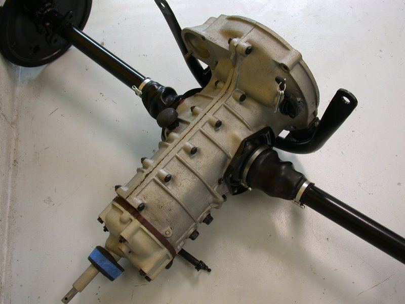

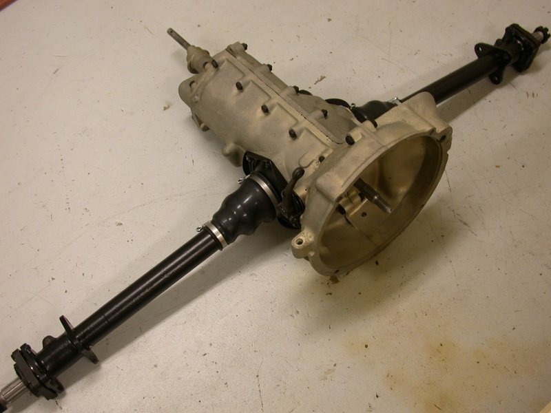

It's a Rancho rebuilt Porsche 519 that is a '52 only piece. what does that mean you ask?
From the outside it looks and mounts the same as a stock Split crashbox. It's a smooth case has the "toilet bowl" filler, etc. But inside it has better gearing and is a full syncro, so no more double clutching.
'51 and earlier Porsche's used a VW crashbox trans.
'53 and later Porsche's used a ribbed 519 trans that used a saddle mount type rear hanger.
'52 is the only year for the smooth case, Split window style mounts.
Petty differences I know, but everyone is doing 519's into Splits now, so I wanted mine to at least "look" correct.
