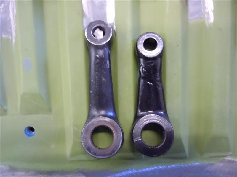

How much did you raise it? What do yo do about the floor? Next time I do one I think I will try a new trick so I can raise it 2" - 2.5" without modifying the floor.

 I like the idea of that, the only problem I see with that is that the turning radius is shortened a little, I dont know if its enough to matter but if it was you can just extend the center pin pitman arm to compensate. Kinda like a quick steer kit on a bug.
 But no that wasnt what I am going to do. I am going to re index the arm forward more and then make a straight drag link that is longer. Read about a guy doing something similar on SBS.

only 38 mm.. then i just the floor open for the punk rock look! wink
