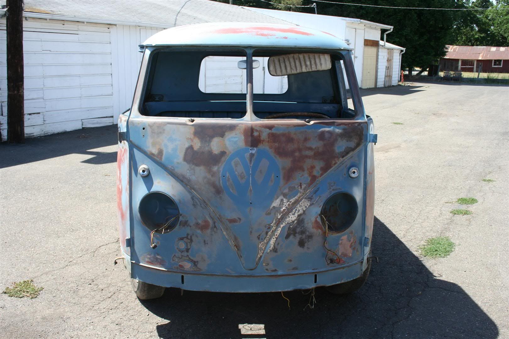

Ran into some old family friends, told them i was getting back into the VW scene, showed then pic's of my Ragtop and also pic's of my son's 66 hard top project.
I knew that this SC was sitting in the woods and asked them if they would be willing to let it go or what they might want for it, they shot me down at first, so I just let things lay for awhile. When we crossed paths again they said to come on up the hill and take a look, the long and short of it is, they were stoked at the idea of this SC being back on the road.
Last registered in 95 on a non-op, parked and left to wither away by the elements.
My buddy Alex , my son and my self pulled her off the hill last week and brought her home, has rust that will need attention but surprisingly solid for a truck that has been sitting for 17 years. Motor turns over but will not fire.
Not sure if we will tackle the rust our selfs or send her out for the work, not sure where to start, I know she will spend some time at The Vintage Warehouse when the time comes.
For now i have been massaging the old respray out of her to see what lies beneath

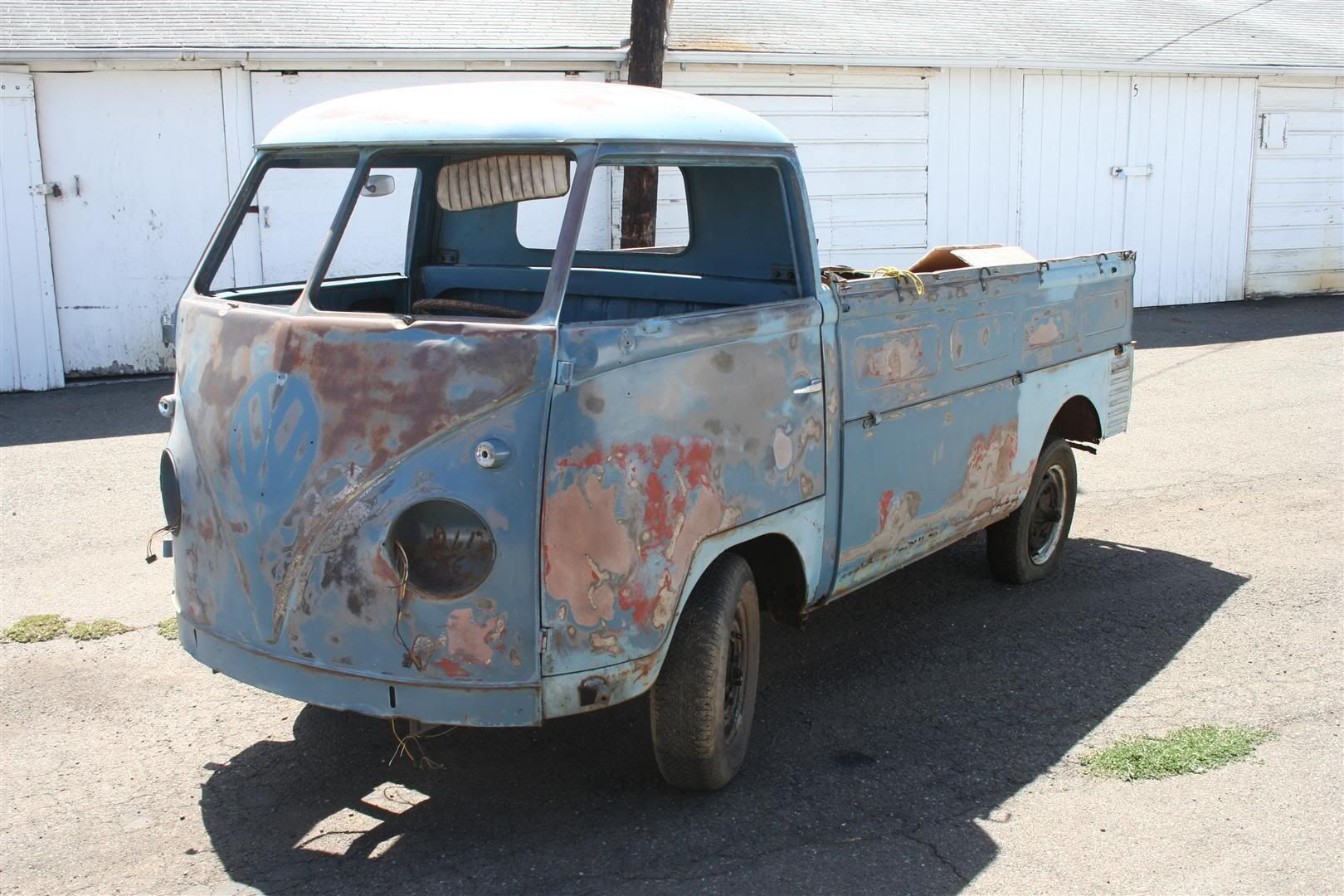

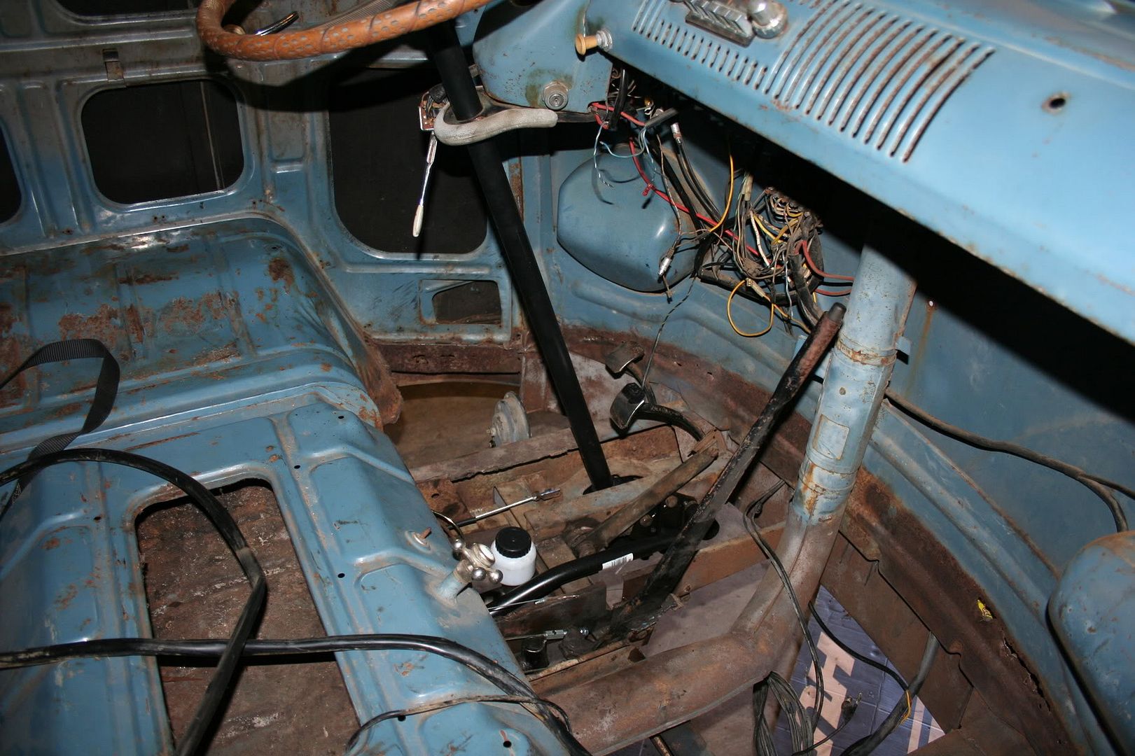

Here's what we started with...

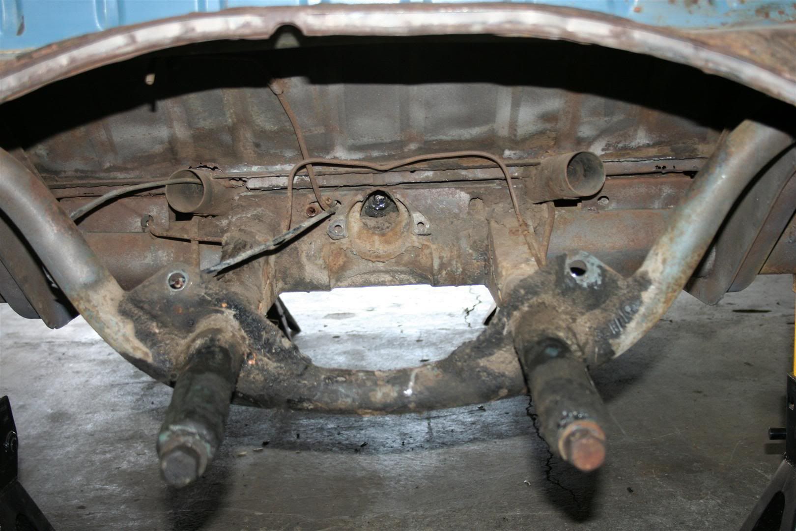

An hour or so later...
I was working on the front door hinge pin removal for Dave, while Mike was removing the trans.
Mike got farther than I did....

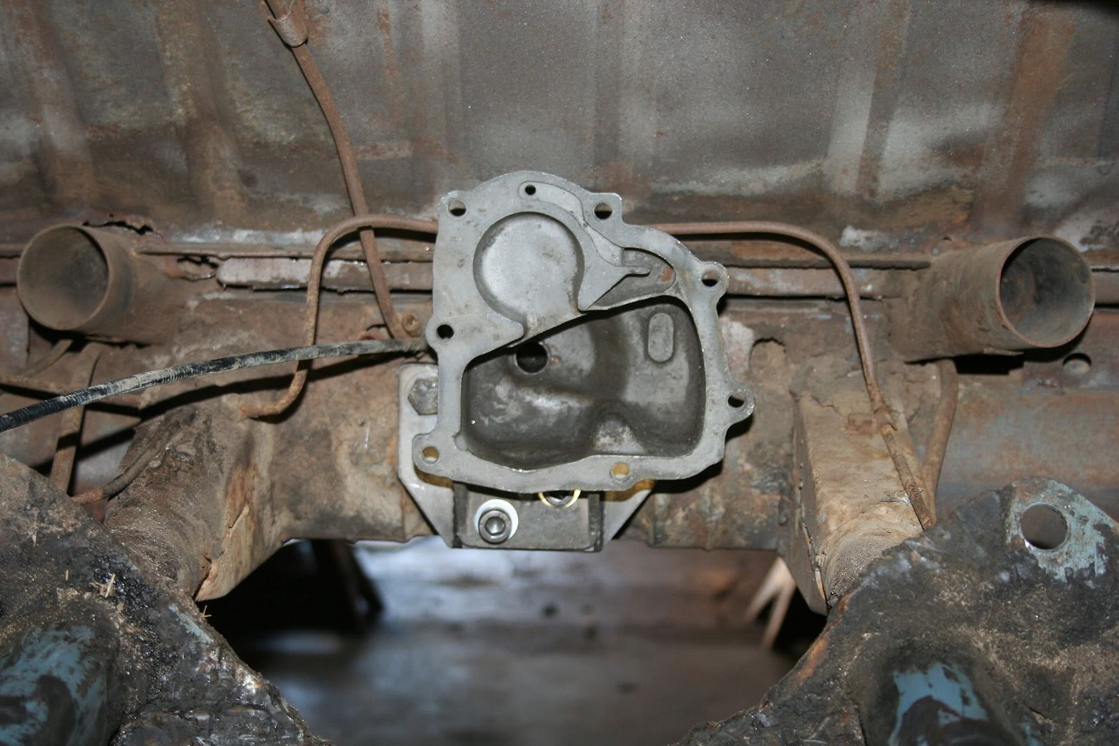

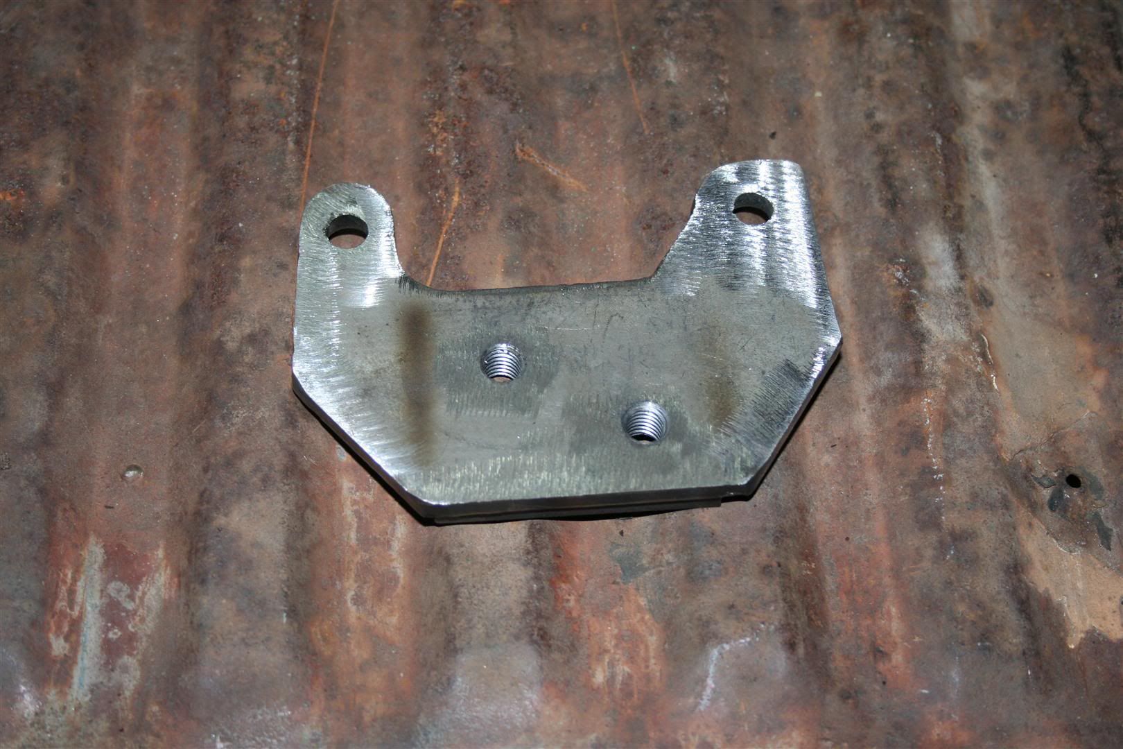

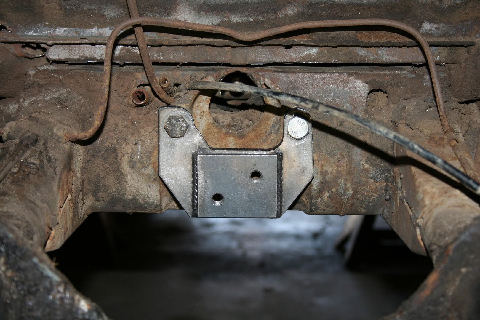

EARLY 56 with tube trans support is cool, but being early means it'll need a conversion mount and new nose cone / hockey stick. The "sweet" mount the PO used is getting tossed.

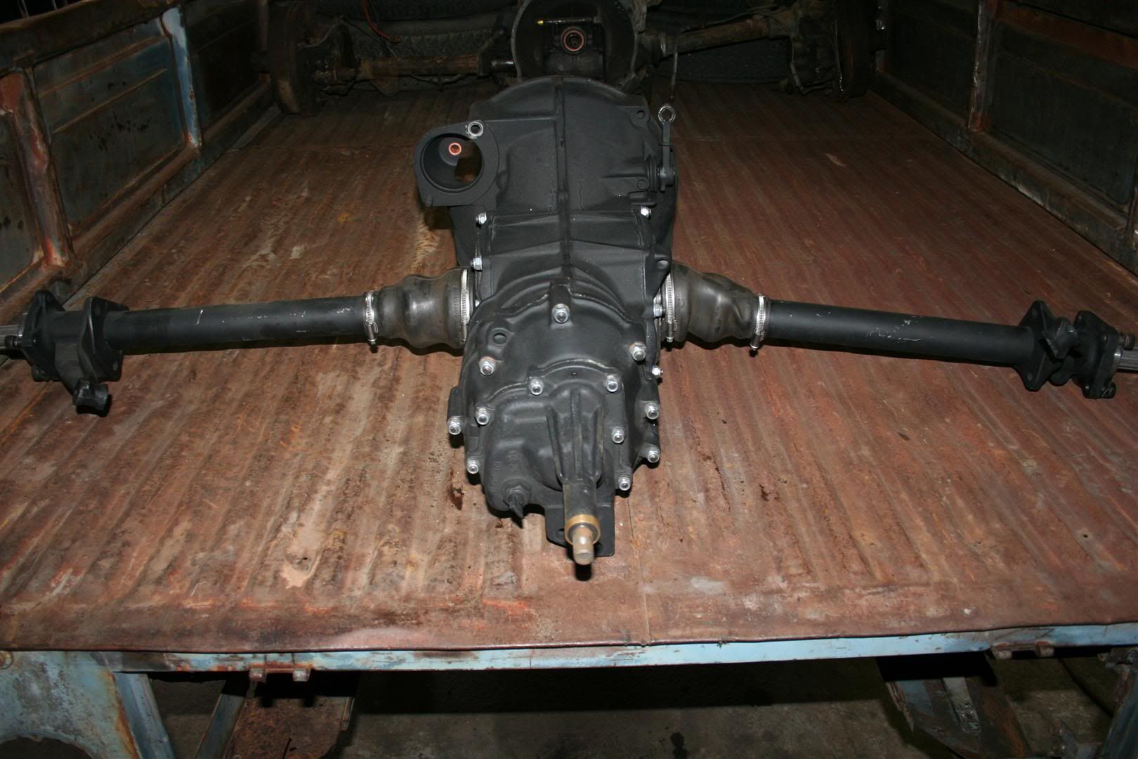

New trans (nose cone will need to be switch for a conversion one)
Conversion nose cone / front mount - Clearanced for the mounting bolts

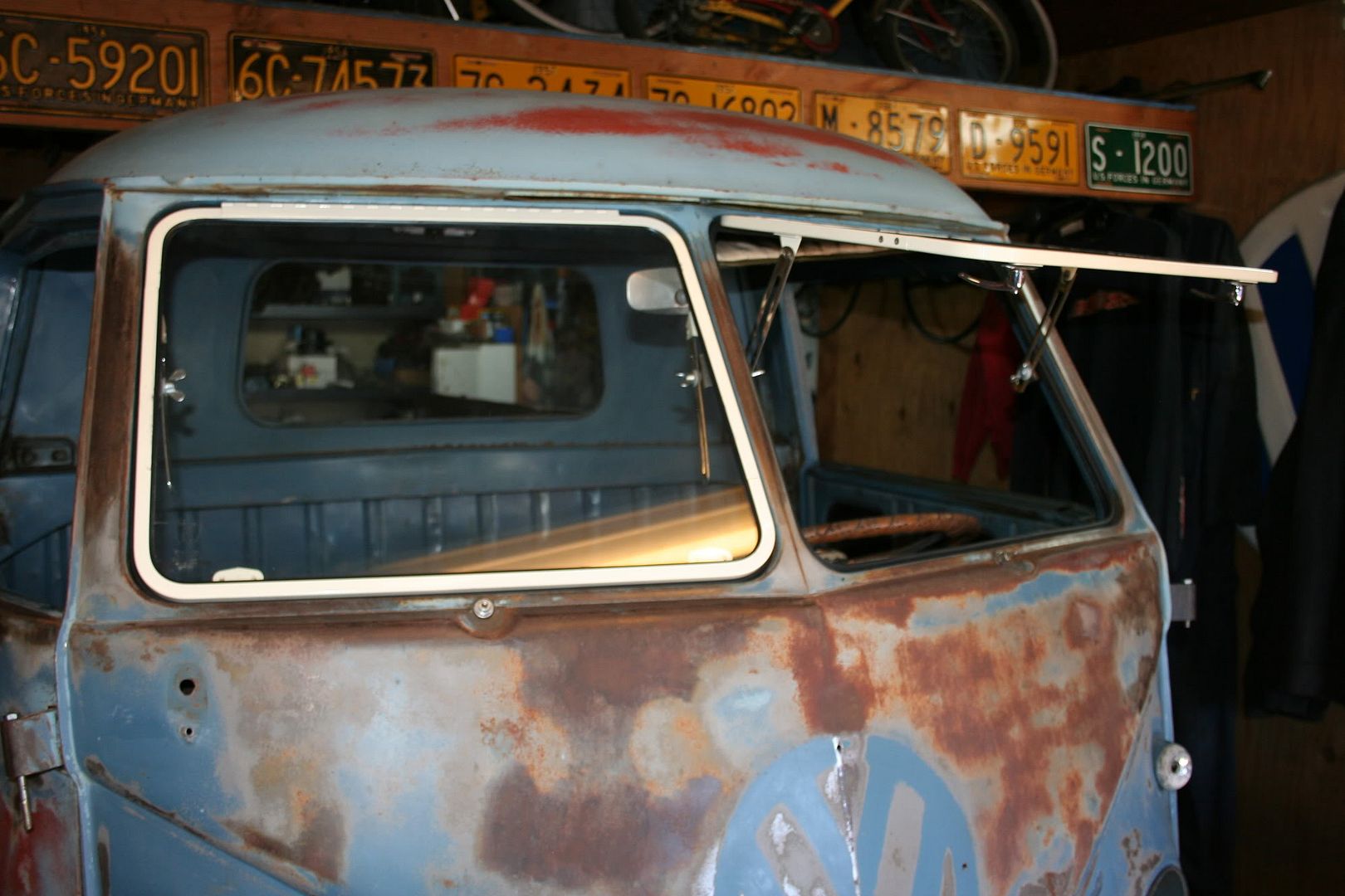

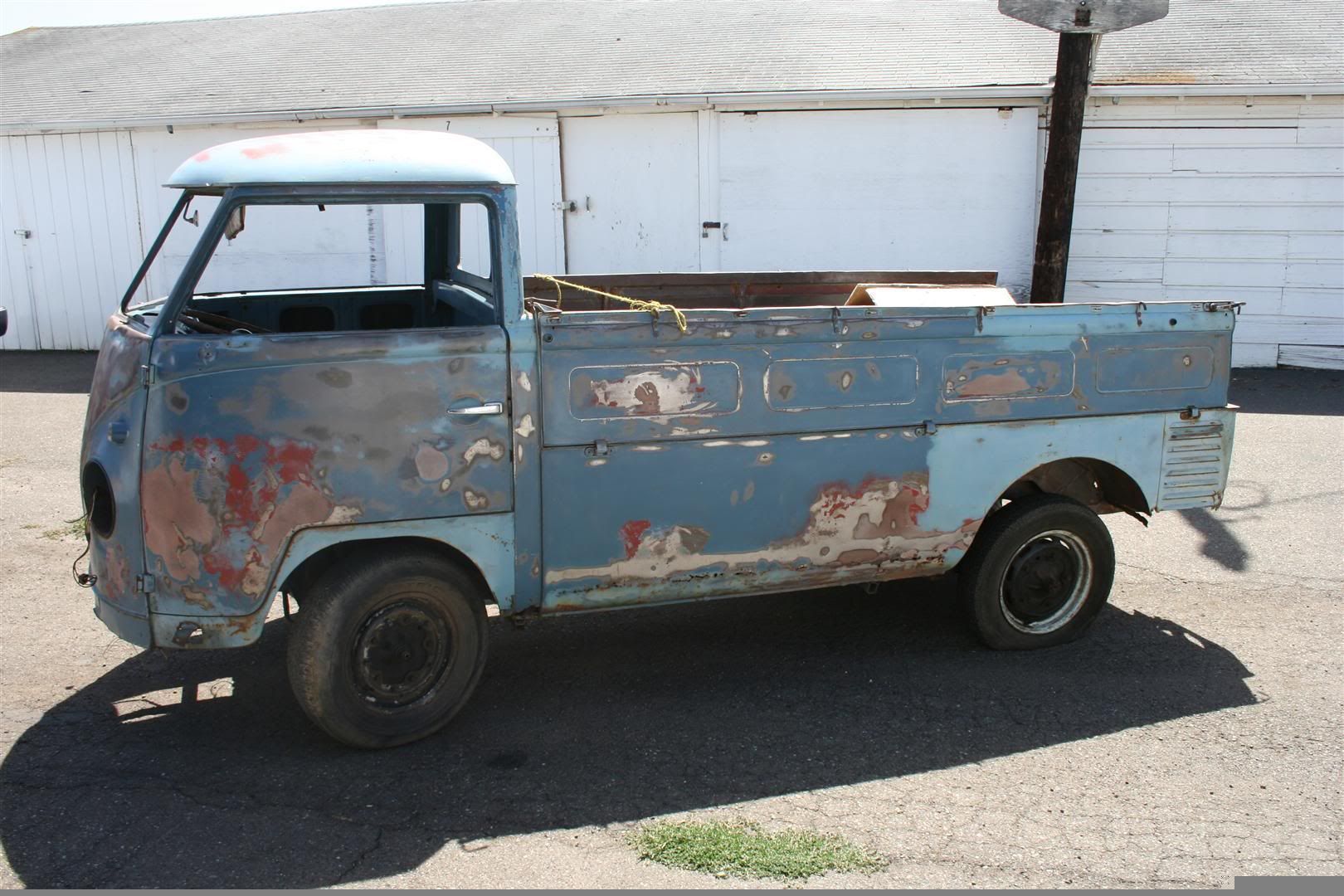

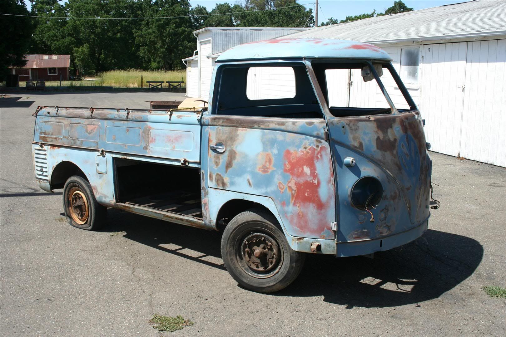

It's been a while since I did an update. I wanted to make sure Dave was happy before posting pics. He got some free time to pick up the SC today and I'm pretty sure he was happy with the outcome.
Here's the latest pictures before I go into "build" details...

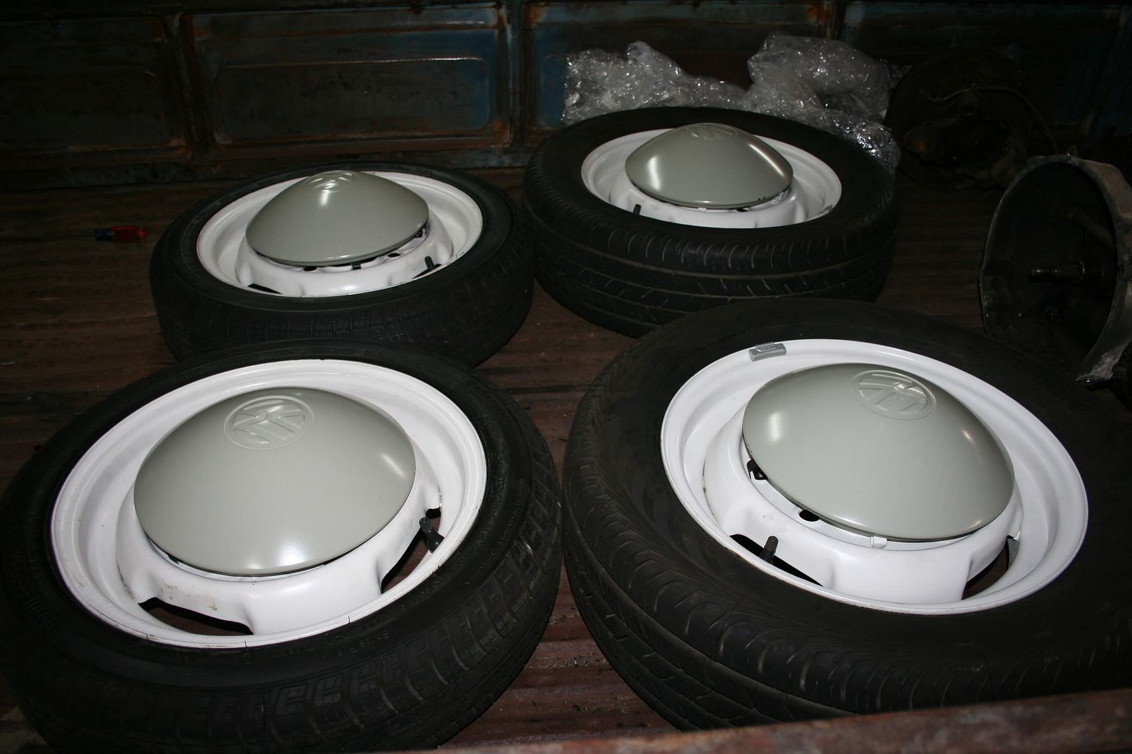

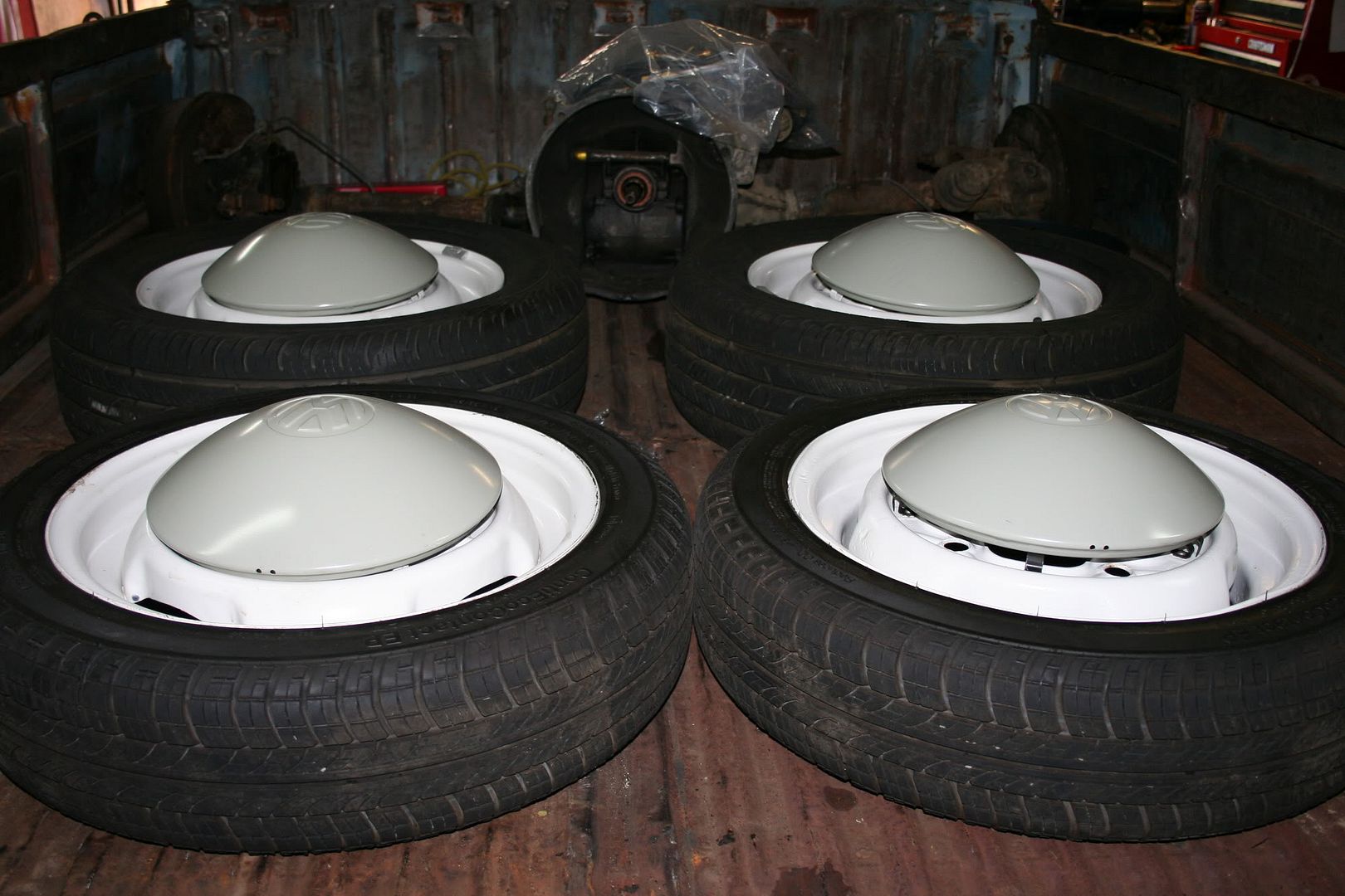

Wheel / tire combo
Stock Bus wheels in the back with 195/60/15
Crows foot wheels in front with 145/65/15

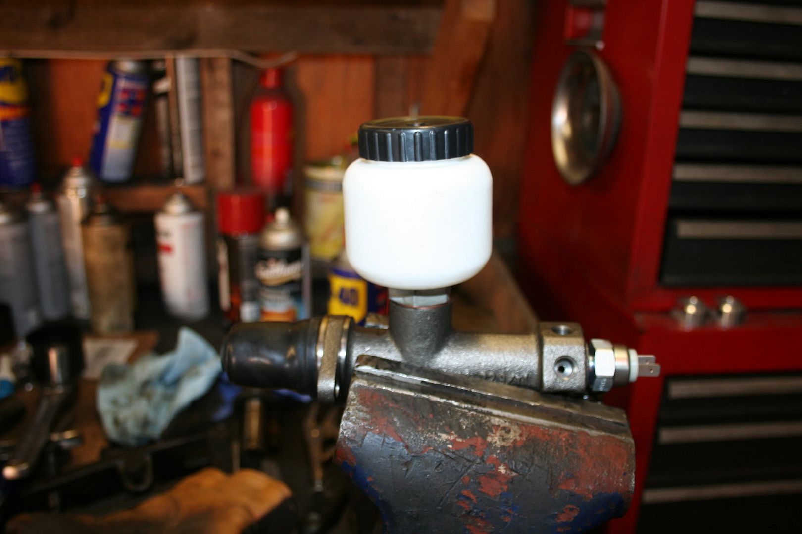

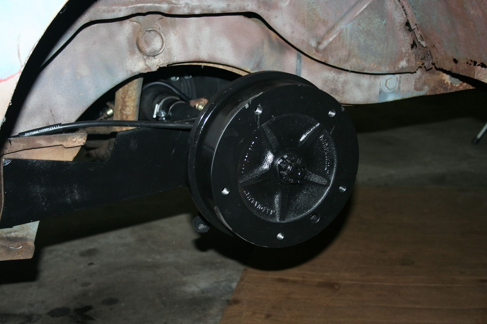

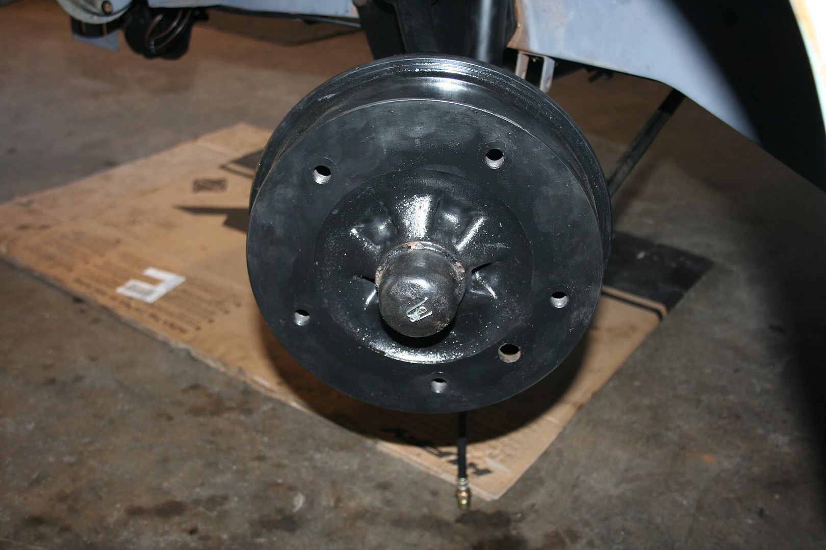

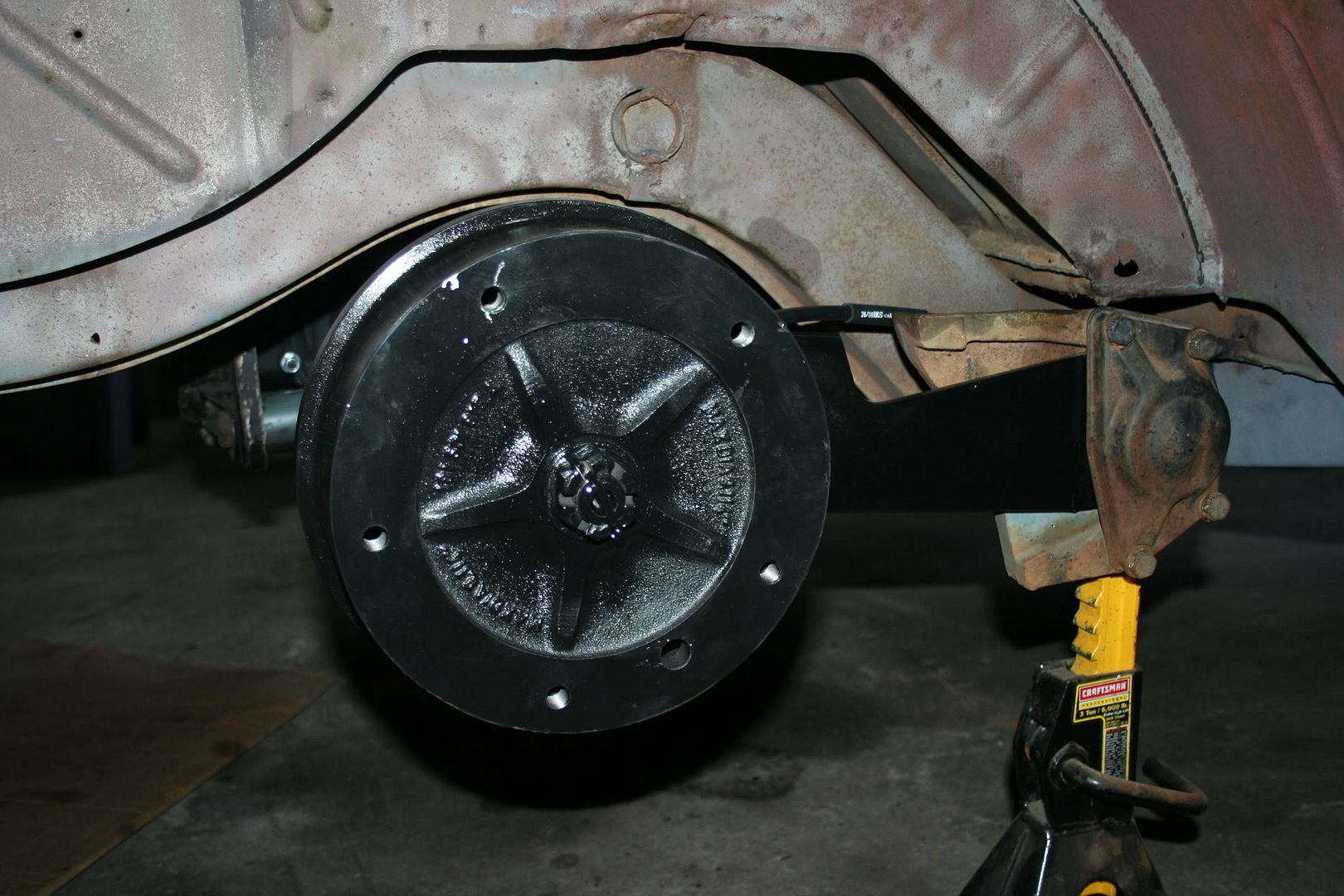

New brakes all the way around.
BIG 64 - 67  stuff up front
New master / reservoir, and replaced a couple front hard lines.

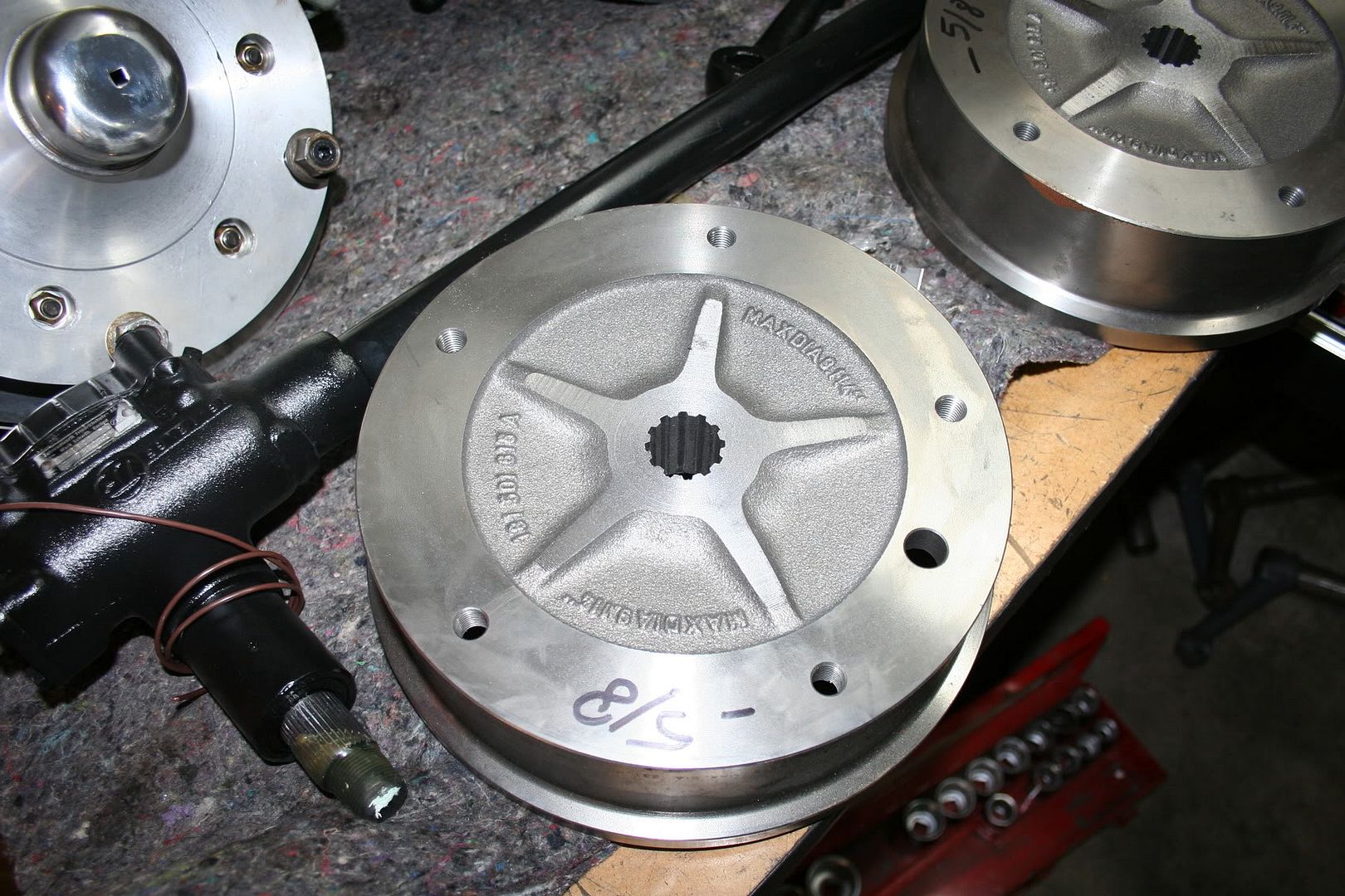

Thing brakes in the rear.
I machined 5/8 off the drums for the short splined axles

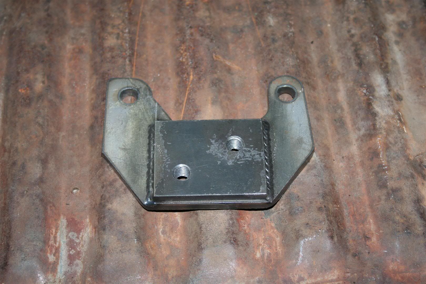

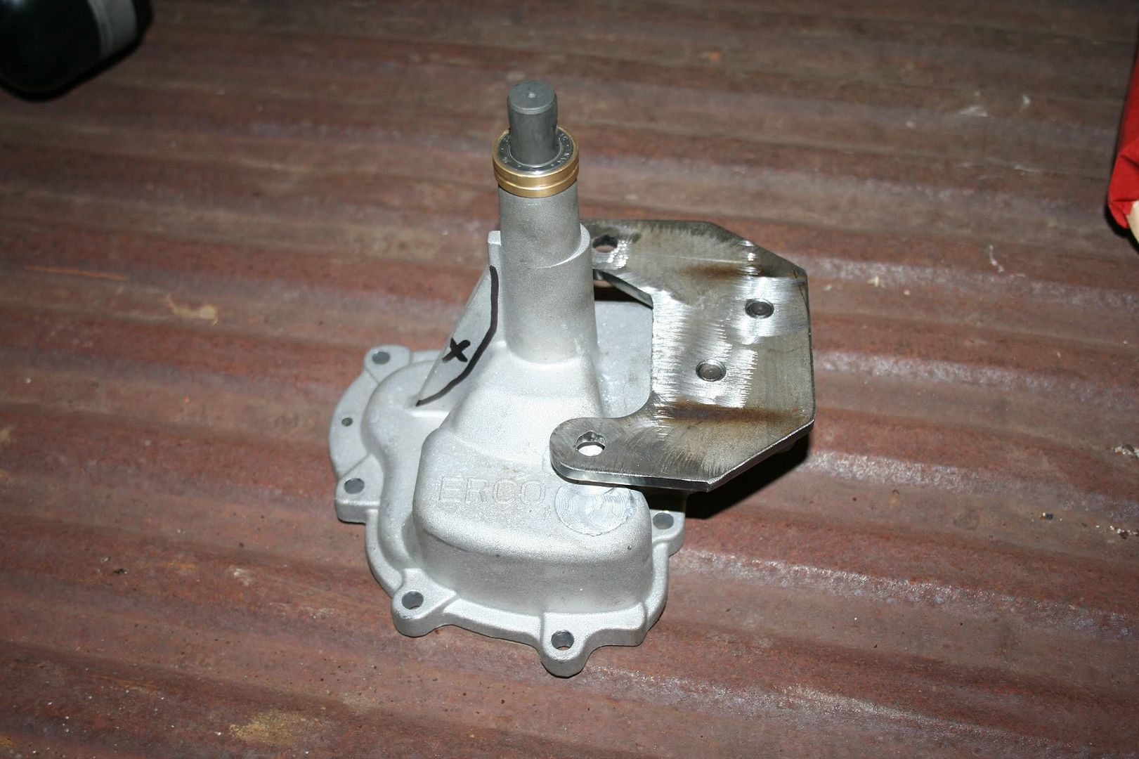

Modified front mount and nose cone for the tunnel trans in early bus set up.
Mount
Mocked up to check clearance
Nose cone added to check clearance as well
"x" marks the spot for cutting....
Trans in waiting on new brakes lines and other details.

It's up a but to fit a tow bar so Dave could get it home. I think with glass, interior *metal* the front will drop a bit, and of course the rear will do the same with an engine and metal as well.
Safaris were added up front as well...
