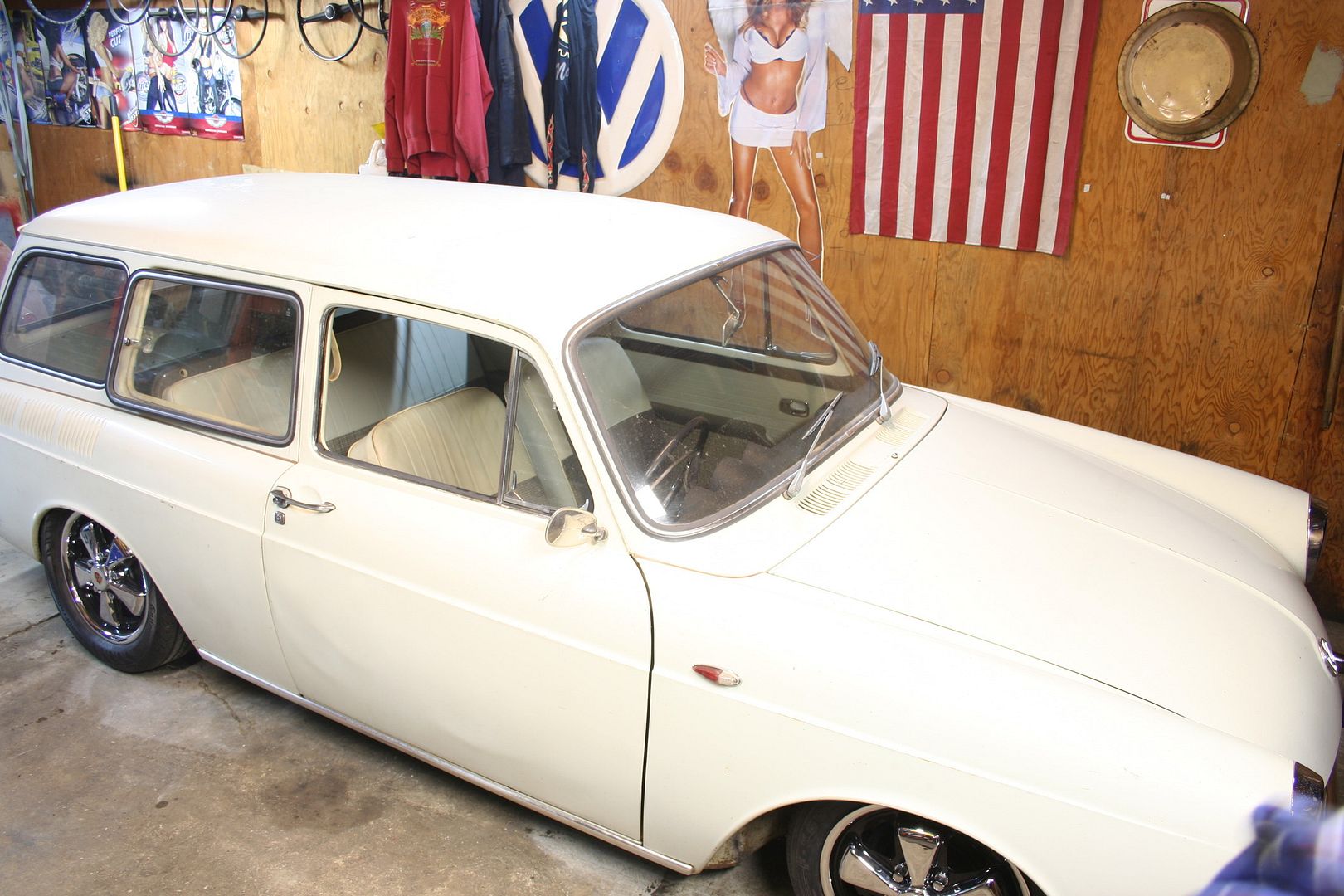

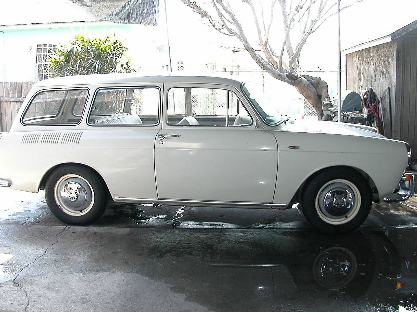

Public now, so let's start of with a "before" and "after" comparison.
« Reply #1 on: January 07, 2013, 04:31:10 am »
My new "driver" to keep me occupied for a bit...
Some of the pictures I saw before making a deal and sending a deposit.

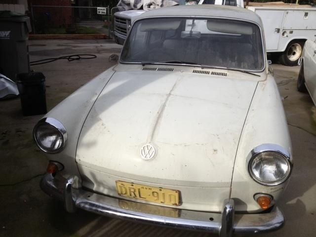

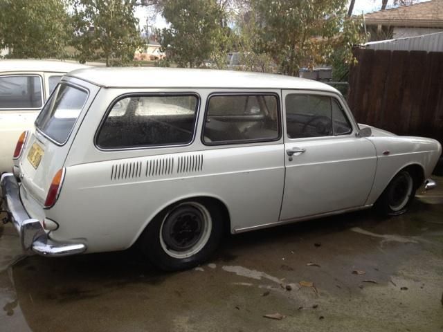

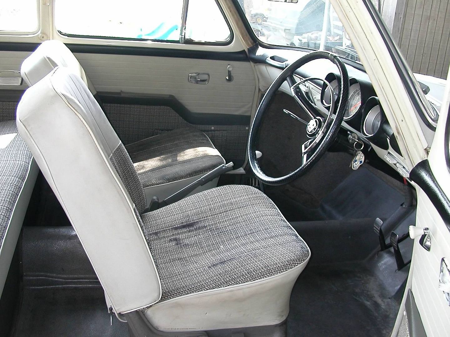

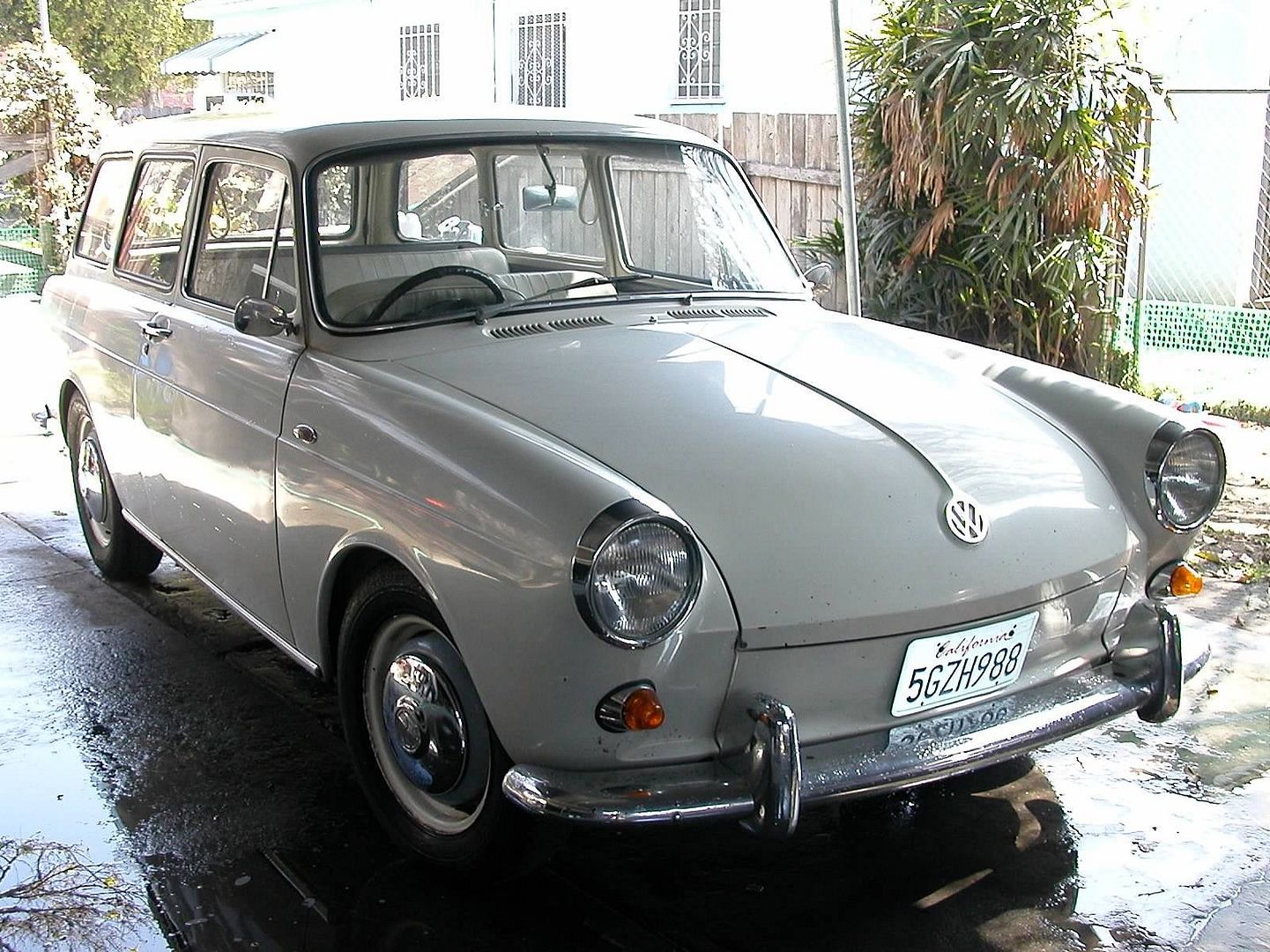

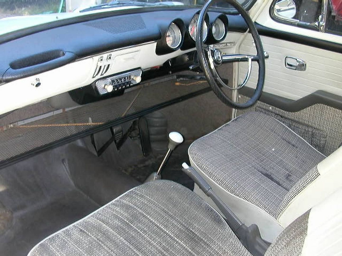

When I went to pick it up, this is what it looked like - Been sitting outside for 3 years, previous owner did a lowering job, brakes didn't work, no battery, and a fuel leak...
I've been after this car since 2008 so I was stoked just to it available again, so I loaded it up. Luckily the interior is still in GREAT shape!
Going down one or two more splines in the front, losing the bump stops, shorter shocks, late T3 spindles with disk brakes in 5x130 pattern, and new tie rods ends.
In the rear I *think* I'll go down 2 splines, shorter shocks, notched spring plates, and because this car is a '63 it *should* have "early" brakes and I can't slip on 5x130 drums. If that's the case I have a set of rear disk brakes I got in a trade I'll run instead.
Nice low budget build, most of the parts need I already had on the shelf or in one of my spare parts piles. So far the only thing I need to buy are front calipers.

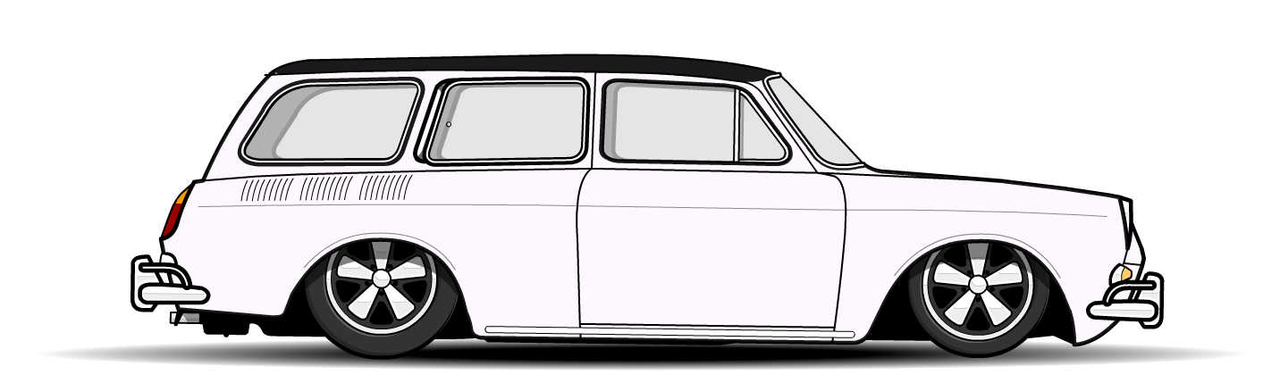

After seeing Vic's Notch with the Black roof I had to do a quick selecta mock up of what that would look like on a Squareback.
I think I like it!
I'm also hoping to run detailed earlies, but I only have a full chrome set at the moment. My extra detailed set is in limbo at Al Reeds...

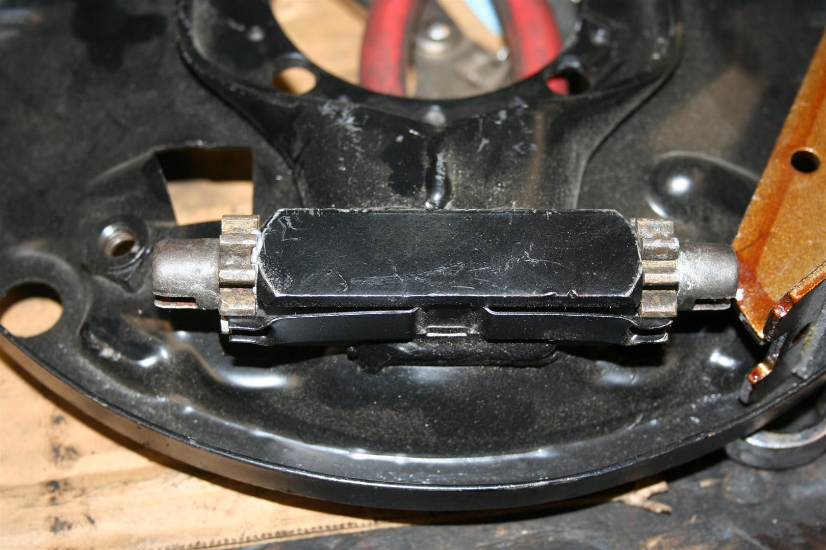

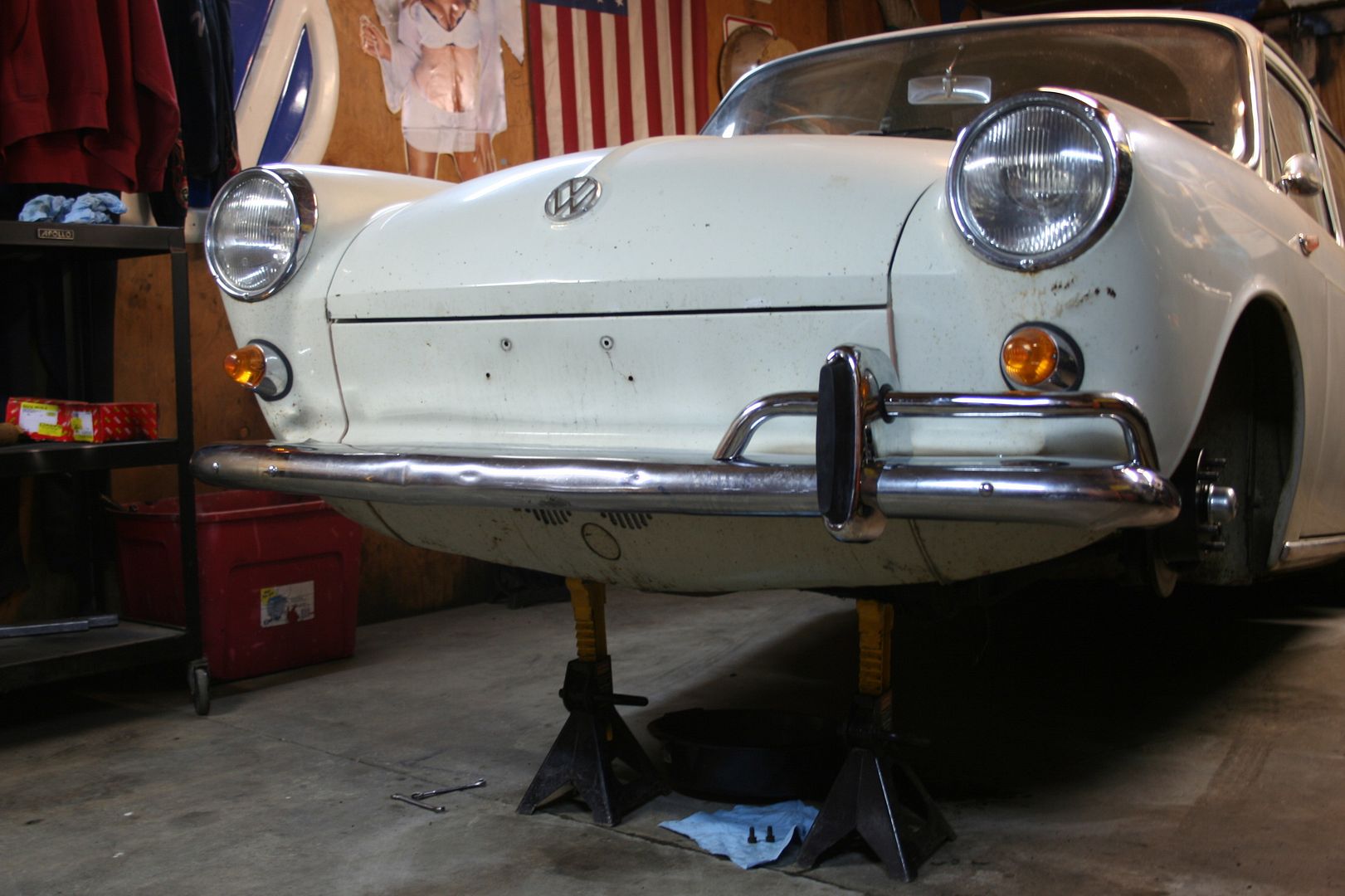

Sunday 1/6/13 I had some free time and some space in my shop, so I brought it over and started with a proper lowering job, and new brake set up.
Front end came apart no problem.
I pulled the spindles and brakes in one shot (complete) and set them aside for my Notch build. The rest of the work was straight forward, having done this before.
I got everything set up and ready to take on the new disk brakes and stopped there so I could paint the rotors and let them sit overnight.

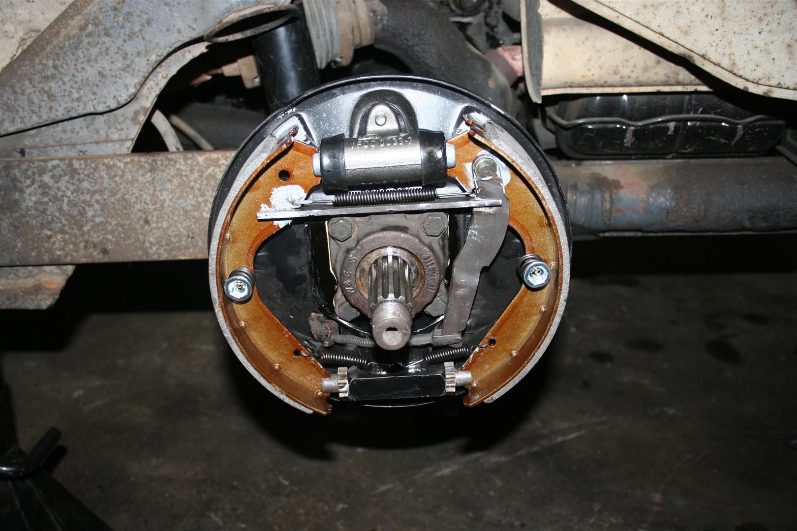

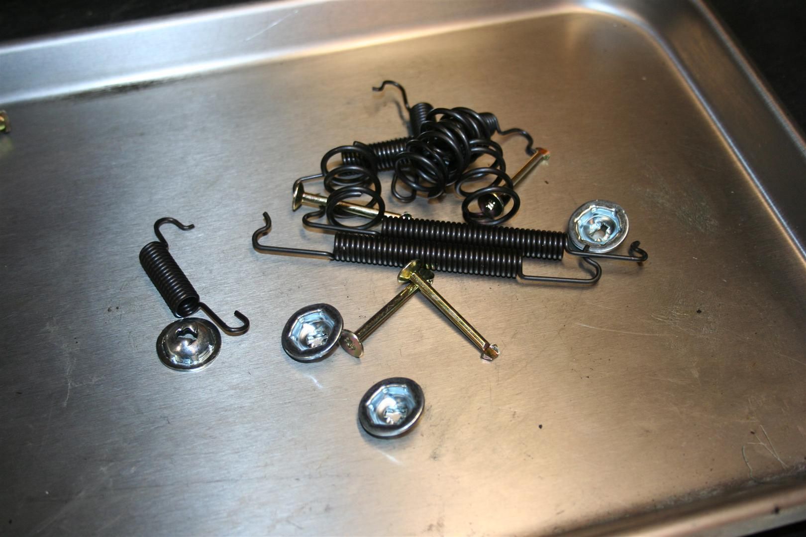

Rear turned out to be more work than I thought. Trying to tuck deep 6's with 195's I *had* to switch gears from the planned disk brakes and go with drums drilled 5x130 so I could get a better offset.
One side down, one to go.
All new brake parts as well. Do it right, once.
Anti-seize on the friction points, new axle seal kit, done!

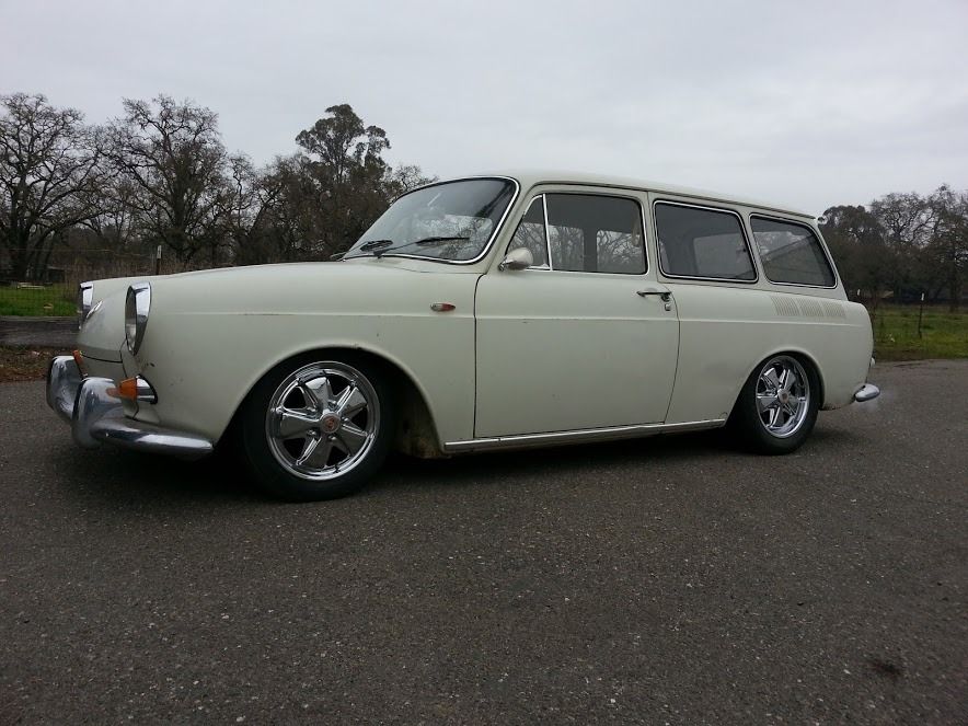

« Reply #6 on: January 09, 2013, 12:47:23 am »
New fuel lines while I was under there today
Fresh oil in the gearbox as well.
Late T3 brakes drilled with 5x130 pattern are on and the deep 6's with 195/60's *just* fit in the fender well.
Go figure, my first adjustment to the rear was too much and I had the ass sag look, so I re-adjusted that and have a nice ¾" rake front to back now.
One nice surprise, the Varga / TRW front calipers arrived today, and they are NOT gold...
No matter, I painted them black anyway. Trying something different than my regular red caliper look.

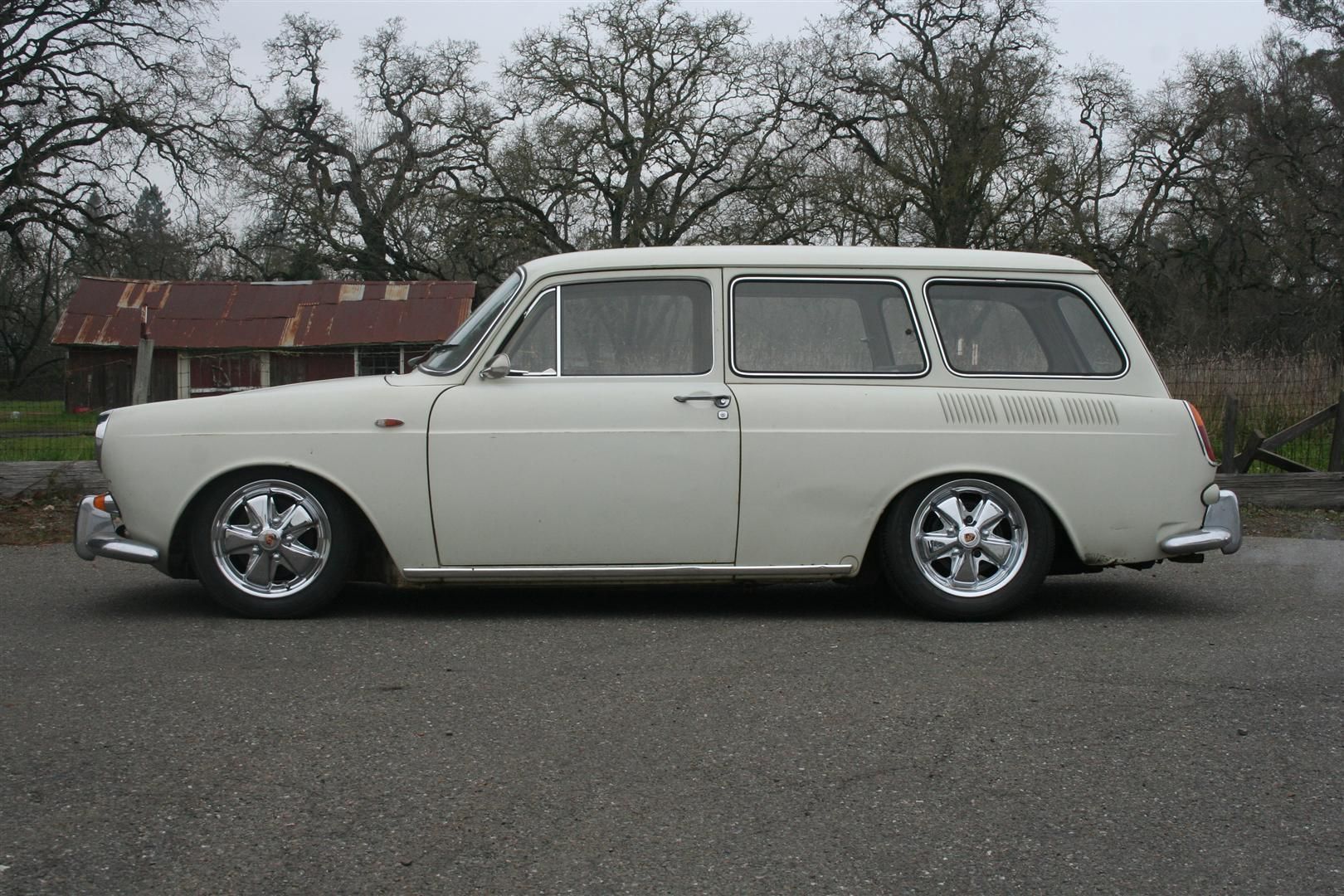

Tight fit in the rear, but it's on the ground again.
Personally I think detailed wheels will look better, so I'm sticking the that plan, just need to get mine from Al Reed....
Bumpers, detail job, done!

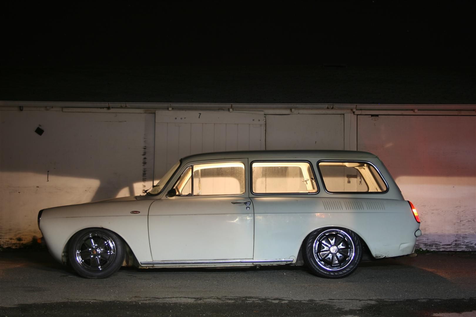

While it was up in the air I adjusted the front down another spline, pulled the bumpers, and threw the detailed wheels from the 11G on the rear.
Here's a side shot for comparison. Day shot was yesterday, night shot was, well, tonight. It's only about ½" lower in the front now than before, but it doesn't have the optical illusion of being higher in front any longer...

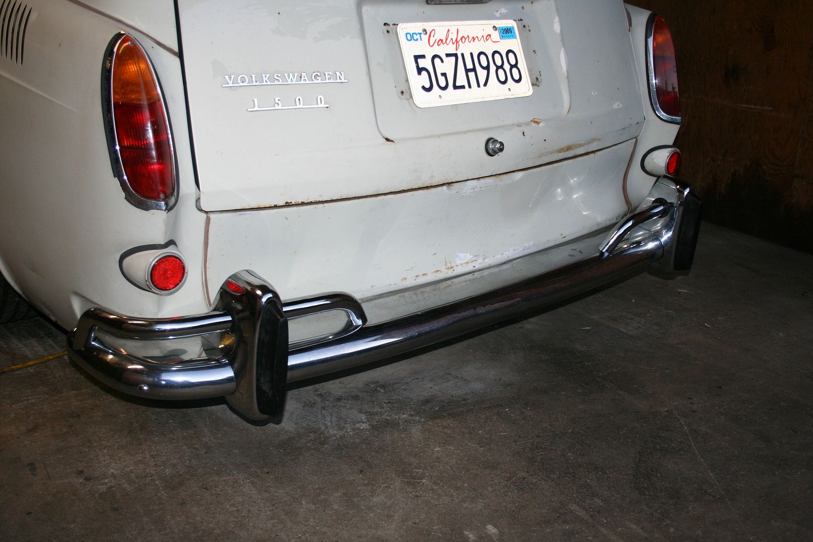

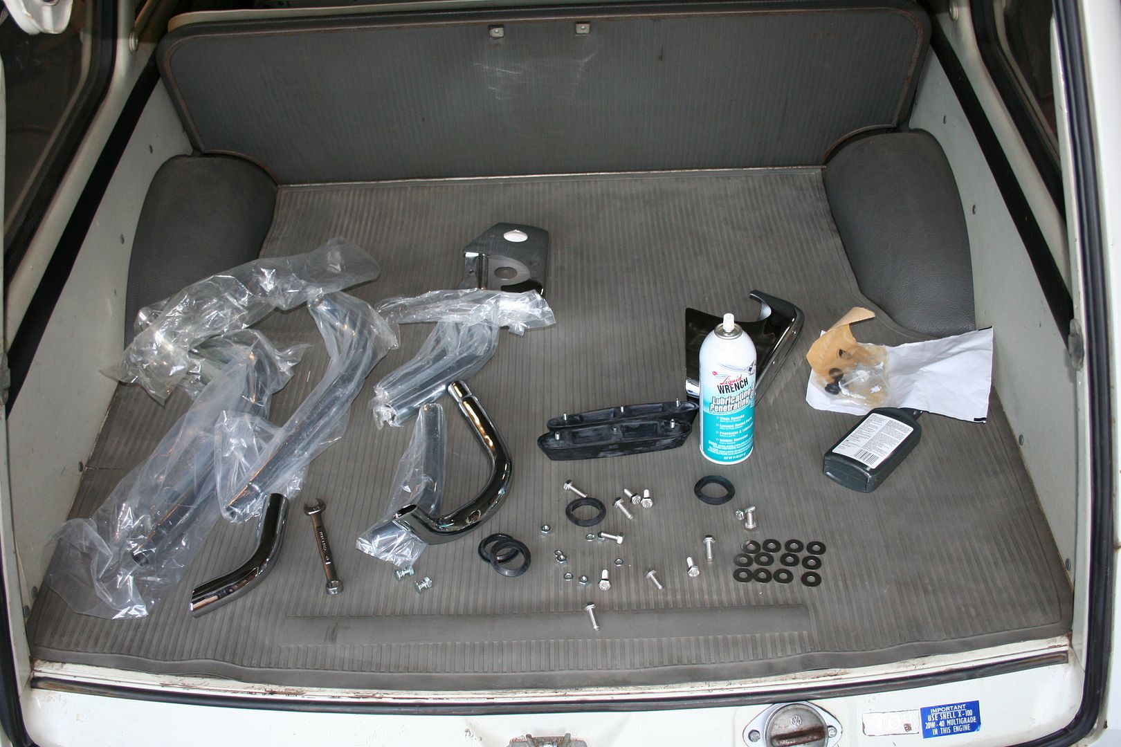

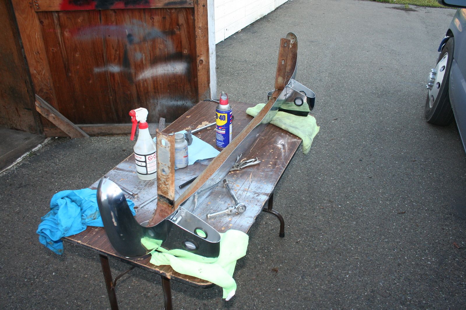

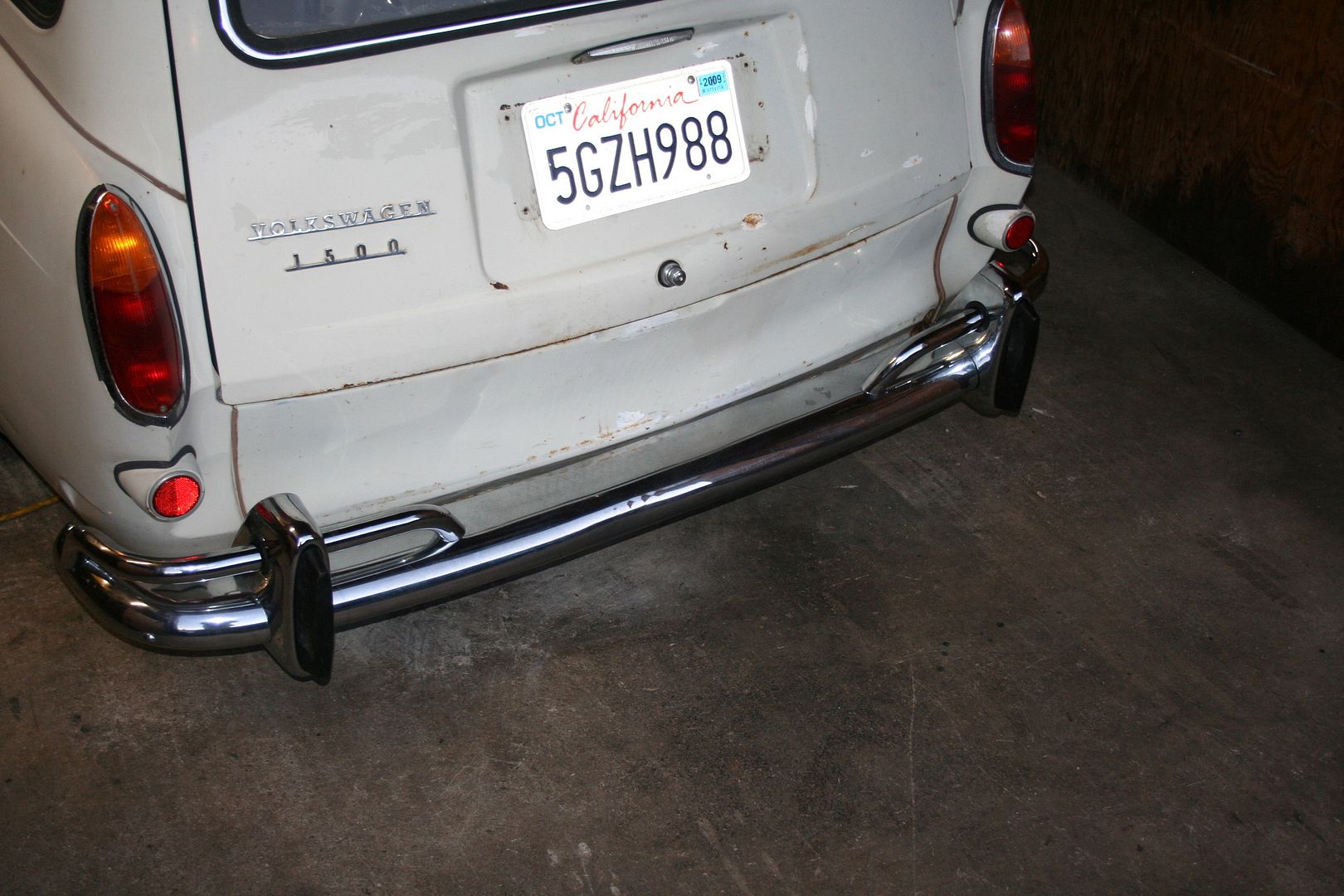

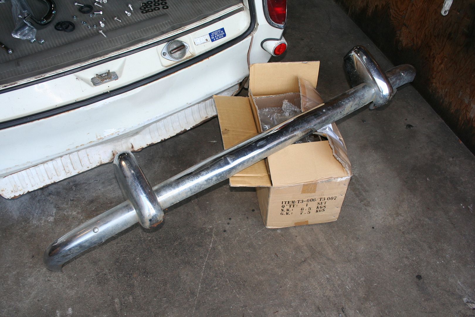

While I was waiting on the tire swap I got started cleaning the "new" bumpers and installing the over rider kit.
While not perfect, the replacement bumpers are WAY nicer than the ones that came on the car, and with some elbow grease they cleaned up good, and match the rest of the cars overall condition.
My old funky table work bench
My NOS work bench...
Rear done and on  thumbs up
Then things got ugly... my kit has 3 left guards and 1 right guard.
So needless to say, the front did not get 100% completed today. Alex at ISP West has an extra guard he is going to next day me in Monday though...

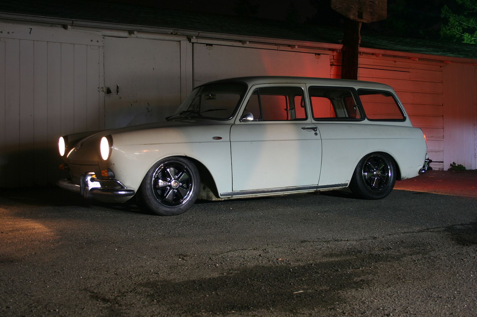

T3 Steve gave me his new master cylinder, but I also have a German one coming on Monday so I really wanted to wait for the German unit. Being impatient I dis-assembled of my OG master to see if I could find the "no pressure" issue. The culprit was a simple cracked rubber plug on the inlet side. Easy enough to replace, and not wanting to wait I put the OG master back in, bleed the brakes and have a solid pedal now.  thumbs up

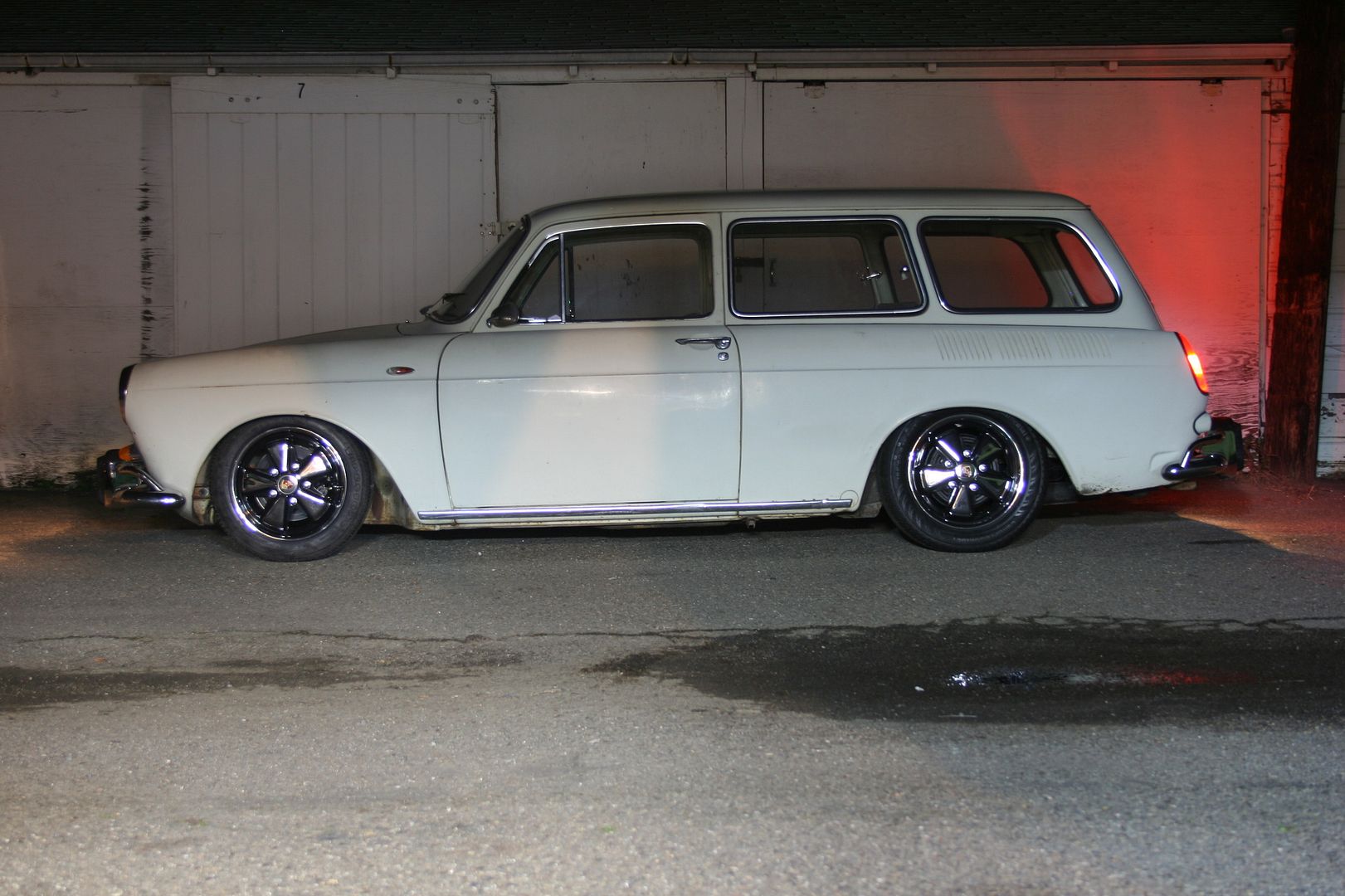

Nice finish to a day, but once again, too dark for pictures, but I did bring my tripod with me today, so here you go...
Tucked away inside the shop for another night.
Tomorrow I need to swap the rear tires (can't have a Conti / Firestone mix on this car and my 11G) give it a proper washing / cleaning and take some decent / better day shots.
Next week I'll get the alignment done and when the bumper guard arrives I'll pull both bumpers and have the whole car polished to see what's under the oxidation.

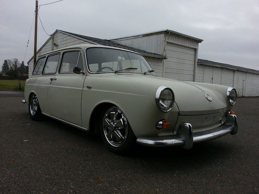

« Reply #16 on: January 12, 2013, 04:30:13 pm »
Needs a good cleaning / polishing along with the missing (wrong) bumper guard issue fixed then it'll be "done" I may even register and insure it!!

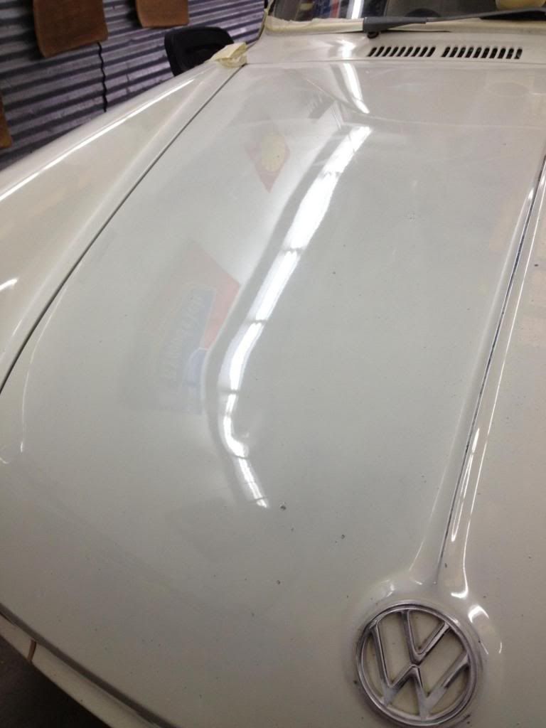

Dropped the Square with the guy I use for details. He's polishing it out this week and giving the inside a thorough cleaning as well.
I held off on the alignment as I'm going to give T3 dropped spindles a shot on this since I plan on driving it A LOT.
I should have a set done early next week. We'll see how they improve the ride. Right now being down 3 or 4 splines in the front I have little to no travel, and the ride sucks. Not typical for a T3. There may be something else going on.
« Reply #23 on: January 23, 2013, 10:34:11 am »

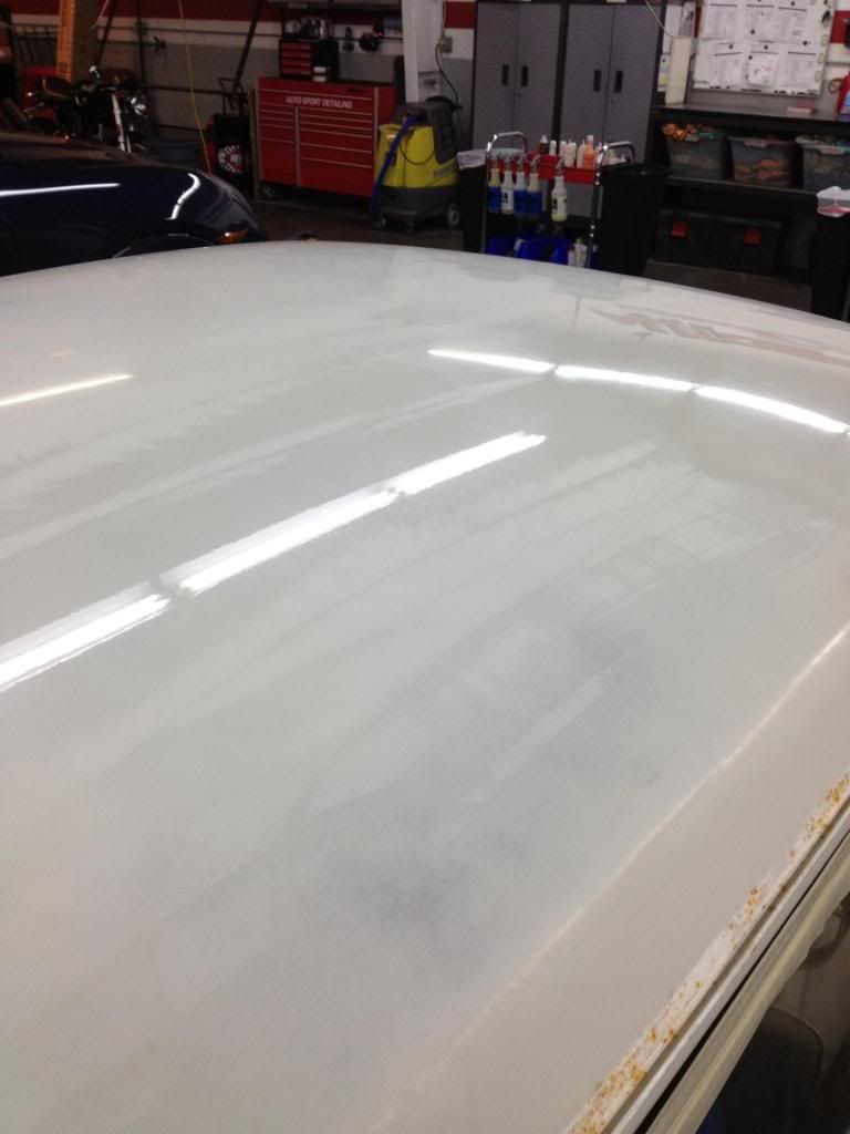

Cell pic updates from the detail shop...
Told him to "go to town on the roof, it's getting painted"
He started there to get a feel for the paint.
The hood was next.
So far all OG except a small respray on the rear hatch.
« Reply #24 on: January 24, 2013, 06:30:24 pm »
Polishing done, rear hatch will need to get re-spray the OG color. No getting around the poor repair done there years ago. I left the emblems off so I won't need to pull them again for the paint / body work.
