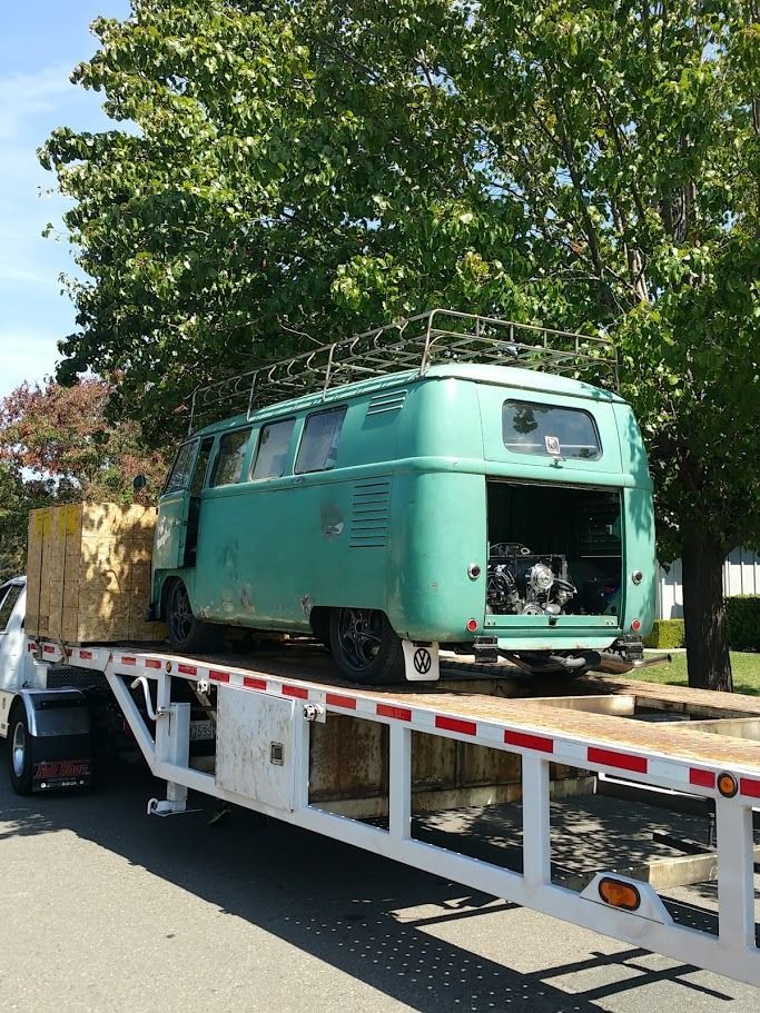

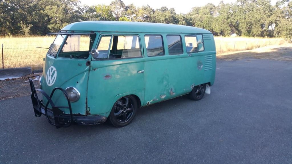

Back in August I did some trading and acquired this Barndoor.
Per the birth cert. it's a 54 Panel originally with safaris and the opening rear hatch
As stated it was delivered to Portugal, where it was "converted" into a Kombi. Apparently these was pretty common and it the reason the bus has rear upper panel vents AND side windows.
From the photos I was sent I knew the bus was rusty and had some electrical issues, but it ran and drove, had lowered adjustable suspension, 4 wheels disk brakes in Porsche pattern, and I *really* wanted a BD. So a deal was struck!

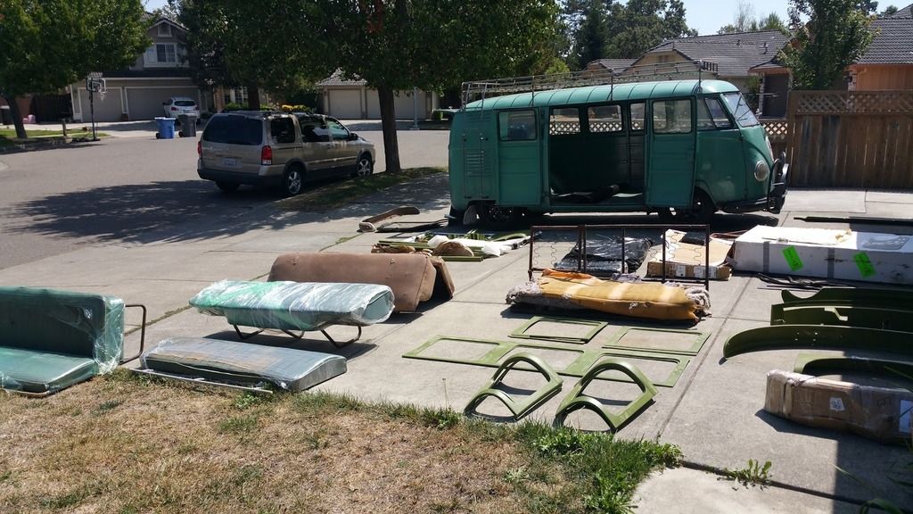

In the deal I received a ton of extra parts (most not needed for this bus) 99% of the Gerson metal to repair the rust, some cash, and a bunch of extra BD parts.
Mike (strictlyvwn) helped unload the bus and lay out most of the part before we hauled everything to storage.

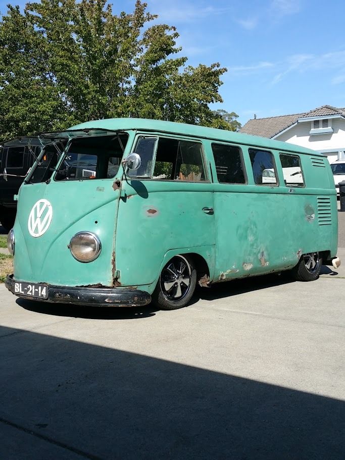

All things aside the bus looked terrible. Stance, accessories, wheels, etc. so my plan was to sort that out and drive it.
Mike, Steven and Ryan came by to lend a hand and within a couple hours we made some progress.
Before:
After:

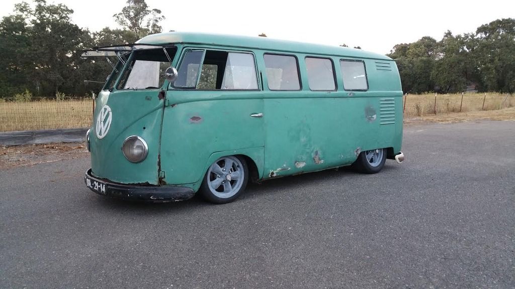

I had to borrow the wheels from my Salesflap while I waited for tires to arrive for my earlies. A couple days later I swapped over to those.

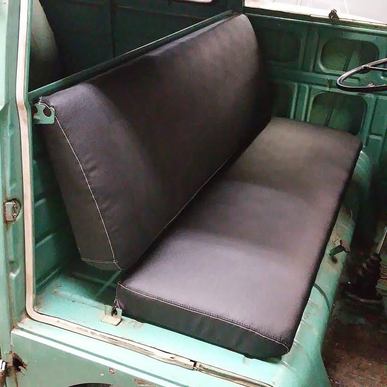

I put the extra set of Turkis seats in, just because, and they looked OK, so I left them.

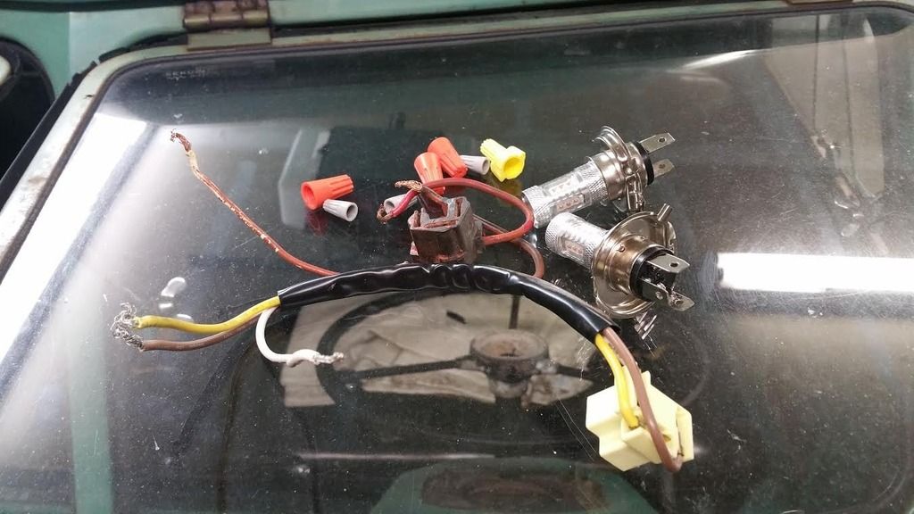

I did an inventory of what was needed to get the electrical working right and the pod sorted out. At the same time I did some handle swapping and key tweaking to sort out a full set of OG handles that work from one key.  thumbs up
Going in -
Coming out -
I even threw an extra repop BD front seat in that I had (I think the pieces are swapped in this picture)

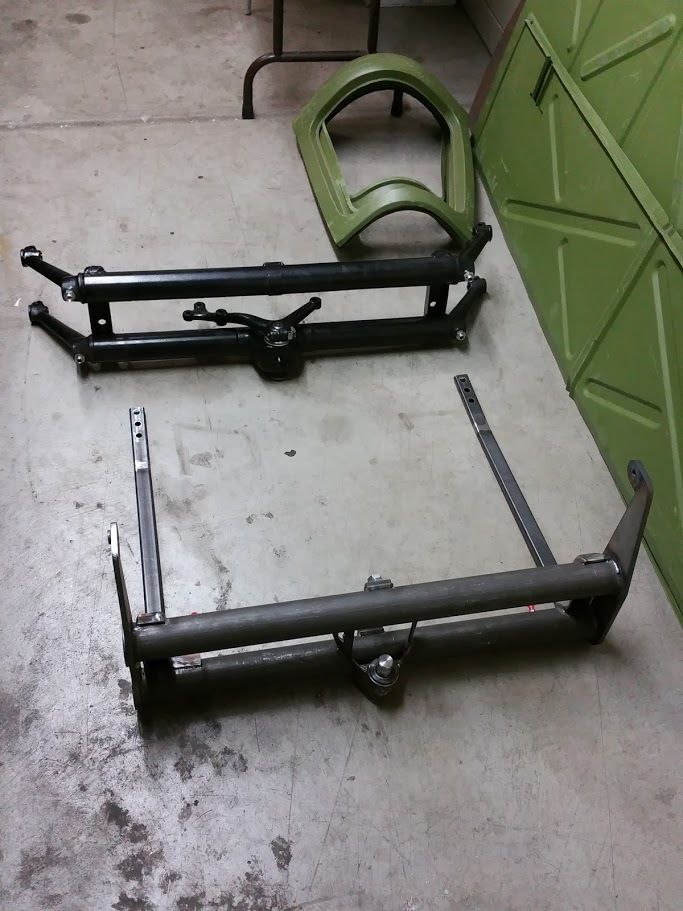

Because the BD came with 3 different narrowed beams I figured I'd install the DogBack needle bearing beam that everyone seems to like.
Butcher shop 6" beam in back, Dogback 4" beam in front
Mike and I handle the beam swap with no issues, but the steering was another story. Short version, the steering box needed to be changed to a later 55-67 style due to the center swing lever.
Because of the previous beam / tie rod fitment, the shift rod had to be notched also in order to get it in and working.

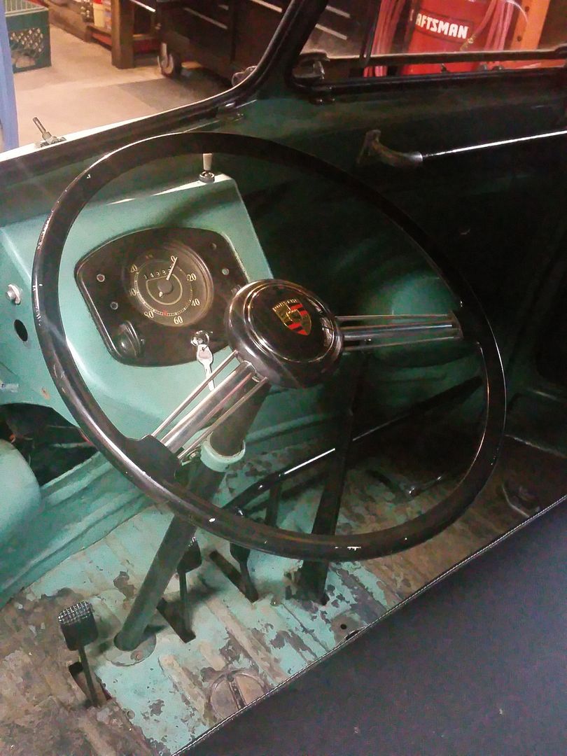

While I was doing that I toyed with the idea of a different steering wheel also.

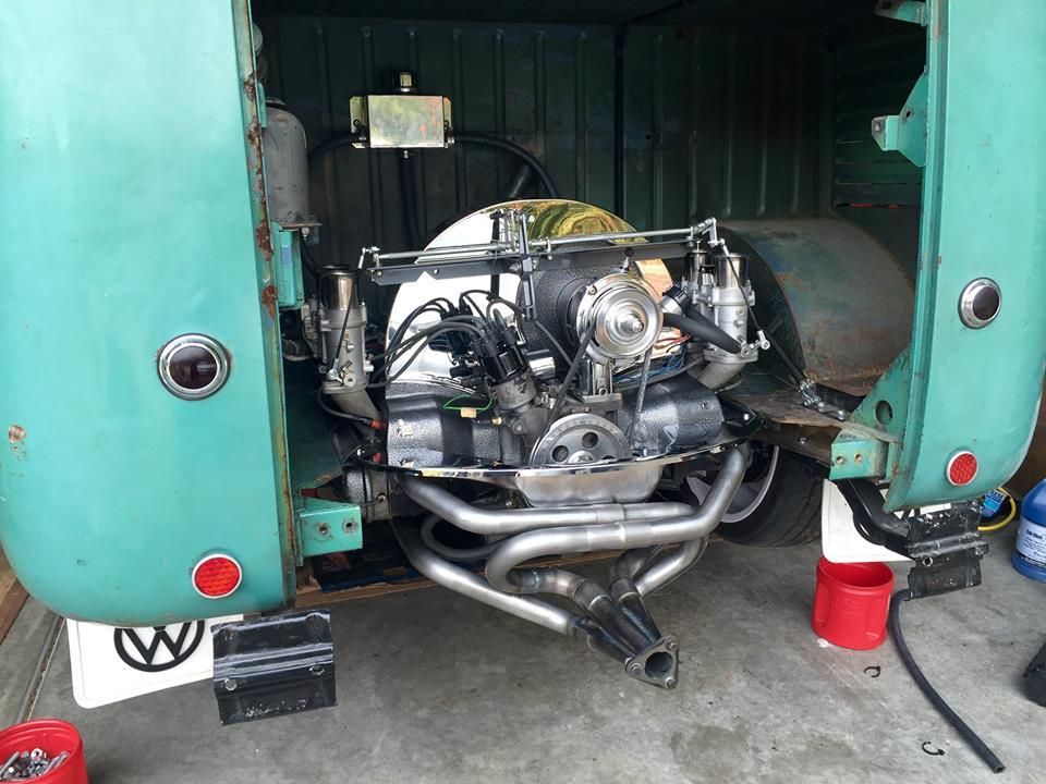

I drove the bus a bit and I knew the engine (supposedly an 1835cc) with IDA's needed to be tuned.
Mike had already changed the exhaust over to a Sidewinder the day it was delivered, so that was one less thing to do.
New tall intakes, better linkage, stacks, etc. were ordered, and we were ready to go!
A few hours later and the super cool chrome tin, poorly designed fuel system, numerous oil leaks, and useless breather system broke my last nerve and I pulled everything out to start over new.

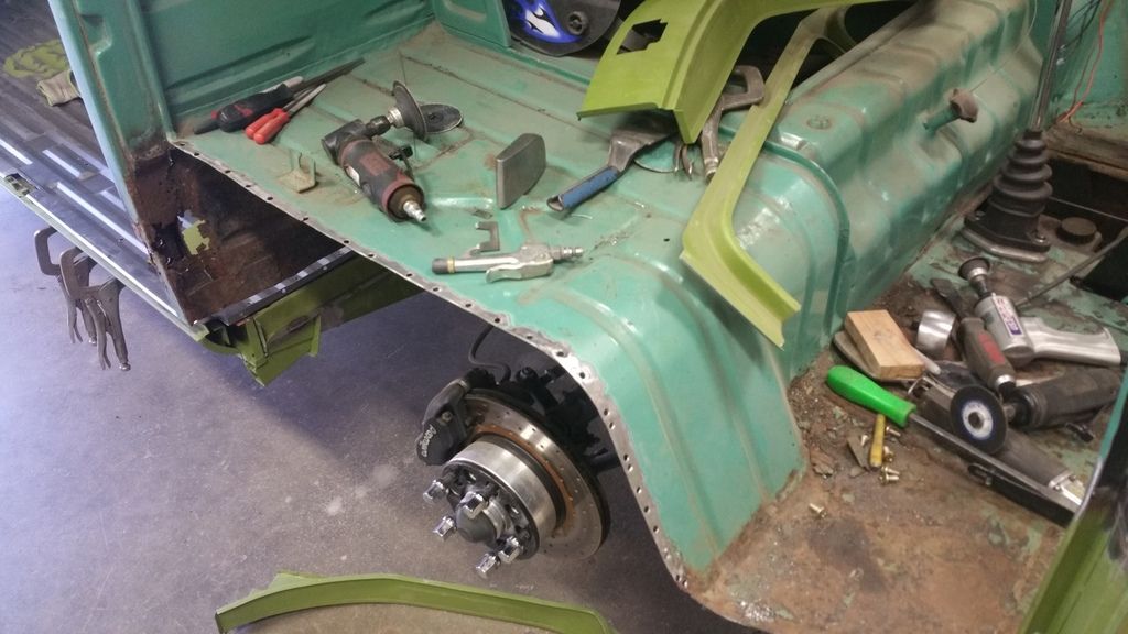

Looking at the BD everyday, seeing the rust and knowing I had the metal to repair it, that seemed like to right next step to take, so Jan 1st I pulled out all the metal that came with the bus and made a plan.
Doors and glass were removed, a few more pieces of metal ordered, and we got started.
Some things went smooth, others did not.
The more we dug, the more issues were found
Current state has the nose mocked up while we wait for new front floor sections and a driver side dogleg. I figure if I'm going this far I might as well do it all.

However the under floor is done, drivers side rock is done, and the cargo floors have be test fit, trimmed, and drilled for welding.
