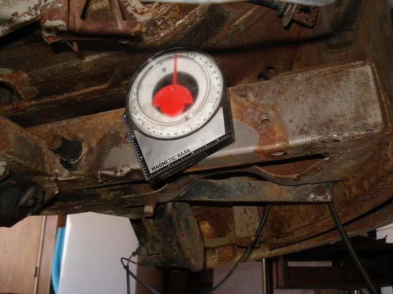

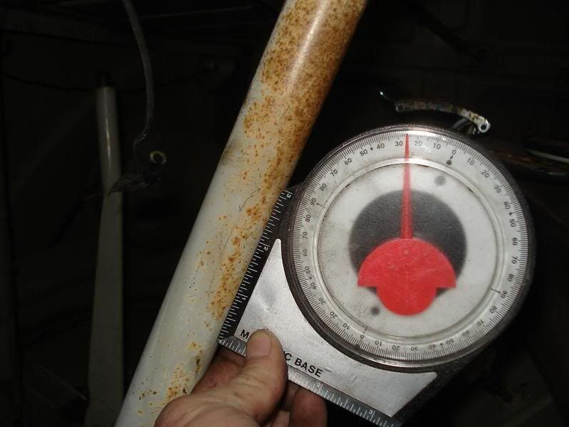

 First I checked the angle og the steering column

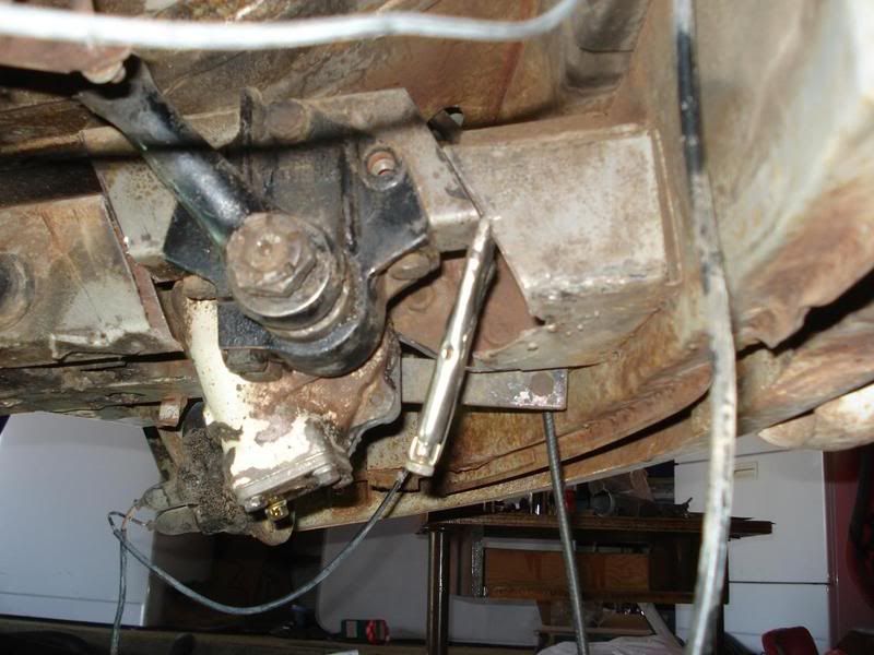

 this is underneath to show how much clearance it gave me

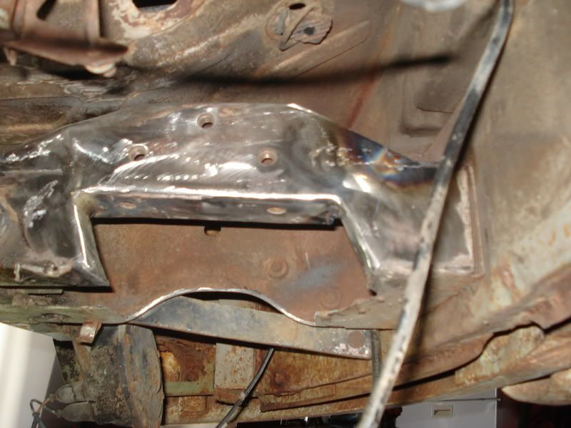

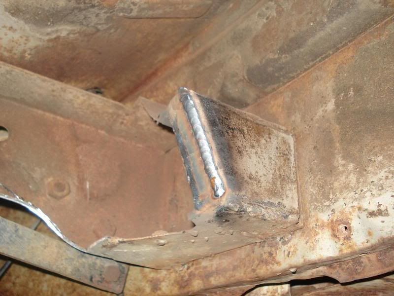

And started boxing and gusseting the raise
I fucked up and got 1/4" plate so it takes longer to cut

On the steering box raise... it looks better all smoothed out...but it weakens the welds, unless there's tie-in gussets inside the rail pieces. I recomend just welding it hot and leaving it.
« Reply #22 on: August 18, 2009, 09:24:24 PM »
 I have no problems grinding my welds flush. Not once have I had a weld brake or even crack.
As long as you get good penetration you are fine. I have built pretty big structural pieces for work (ironworker)  and have never had a problem
 Fact is I over built the box raise. I understand what you are saying but I have complete confidence in my welds
