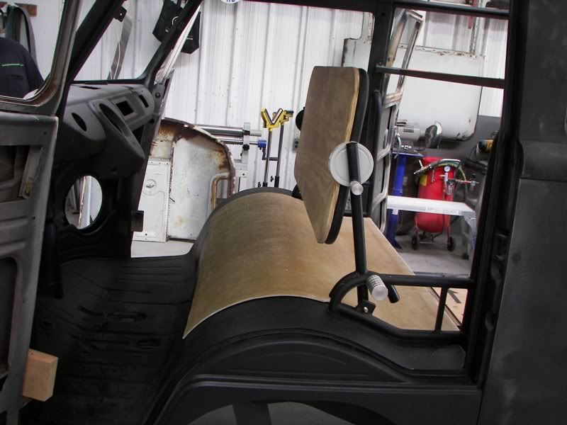

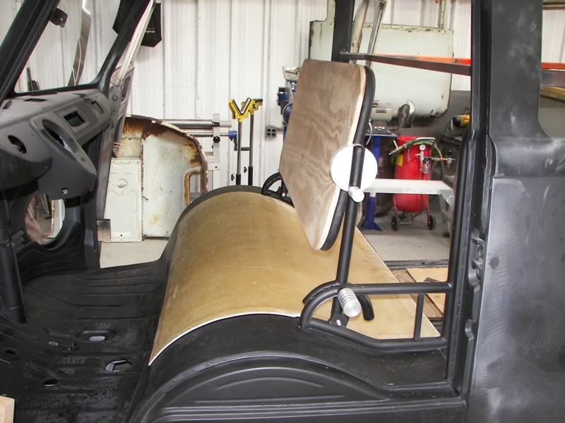

« Reply #3 on: August 18, 2009, 05:04:44 PM »
Damn! Nice start on a clean build. With my short legs and that driver seat I wouldn't be able to reach the pedals for sure icon_lol

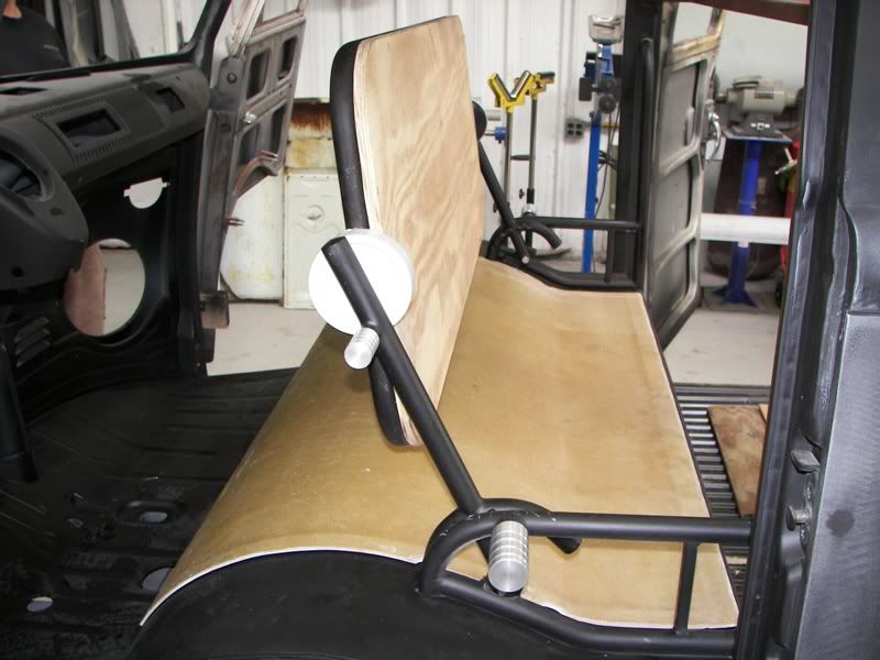

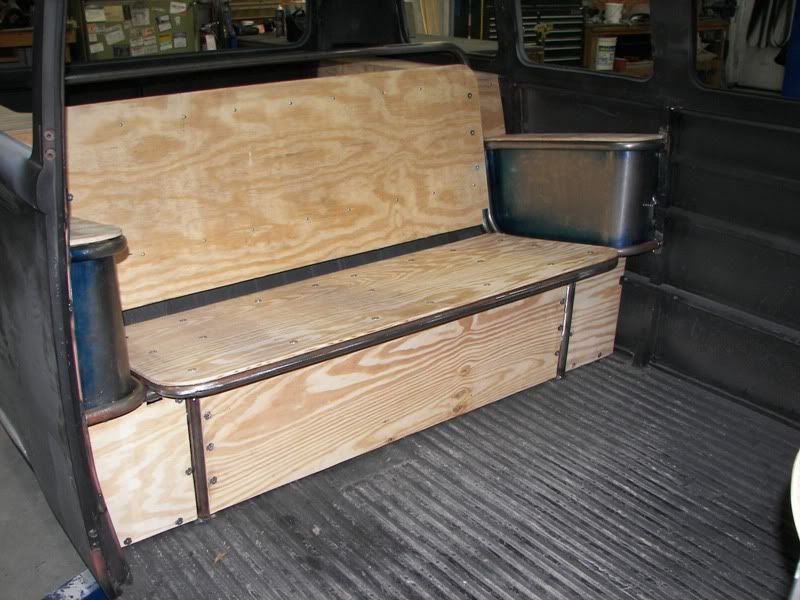

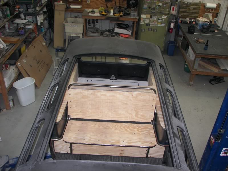

Thanks Slowlow for the nice words, I'm diggin' the 16's myself biggrin and folks55 I'm sure you could find one of these positions to suit you............

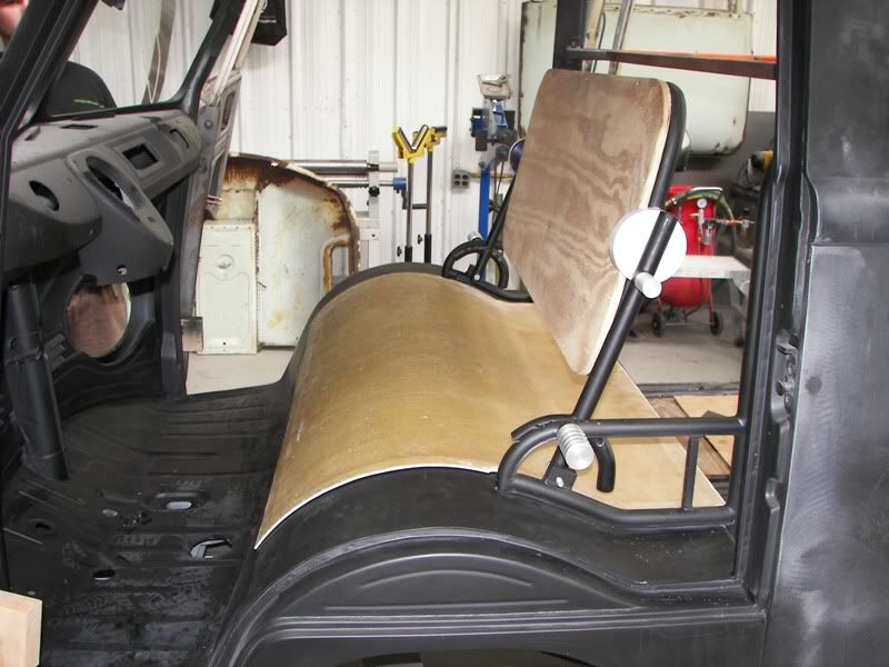

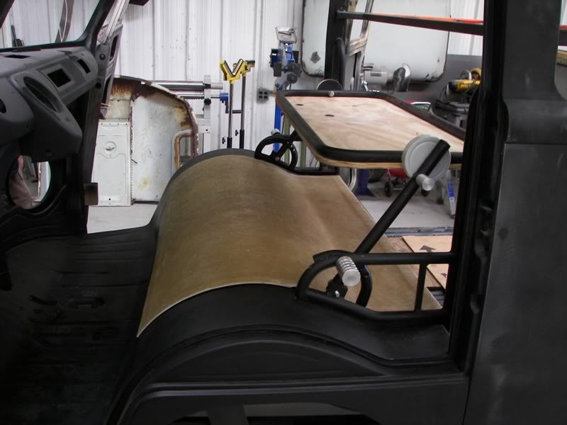

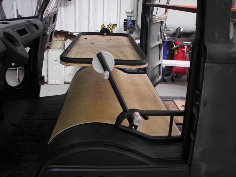

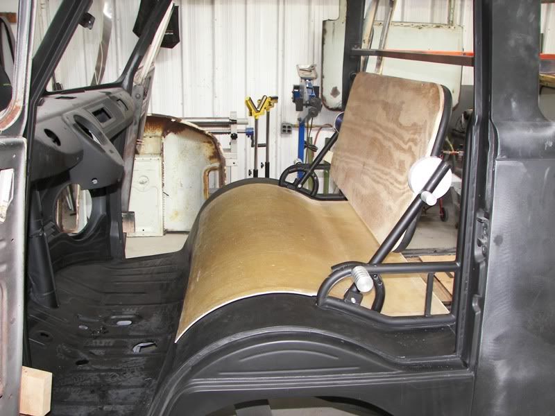

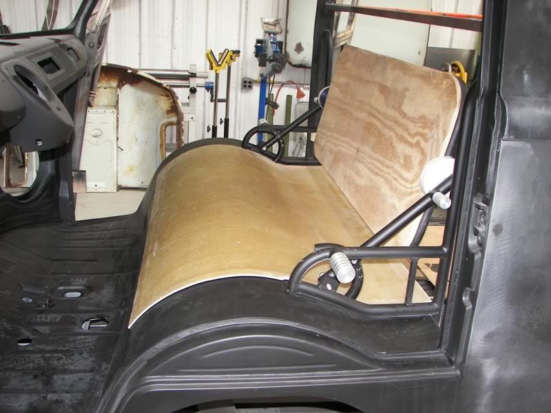

Rearmost..........
1 Notch forward...........
2 Notches forward.......
3 Notches forward..............
Or 4 ...........( You gotta be a short Mo-Fo to use this position )  icon_razz
 Maybe you want to hang at a show and face the people in the back of the bus.......
 Or simply stand outside the bus and find a place to rest your cold beverage or set-up your laptop or other device..............
 Or maybe from inside, place to put down a sandwich or............

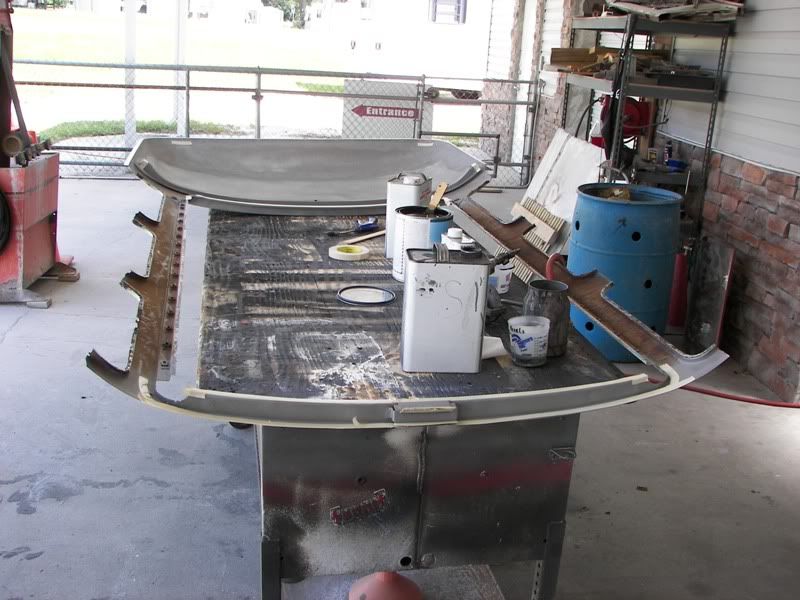

Here's a little detail shot of some of the mechanism and such needed to pull this off........
This is the type of thing that Skidmarks garage likes to create,
Not nearly finished yet but starting to come together as a flip-seat-wanna-be

Wow what a trip. Nice clean work..
« Reply #5 on: August 18, 2009, 11:41:59 PM »
Nice job on the seat.
Looks like the same thing as an SO-33 Flip seat, only more up to date.
Yeah, and fun to make too...........

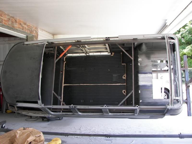

« Reply #11 on: September 22, 2009, 05:11:41 PM »

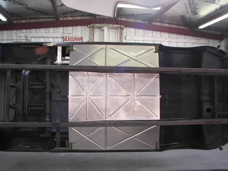

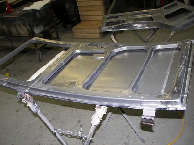

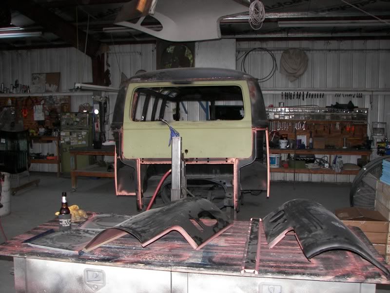

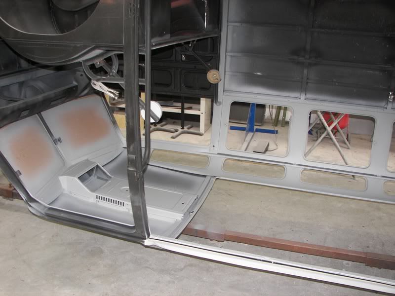

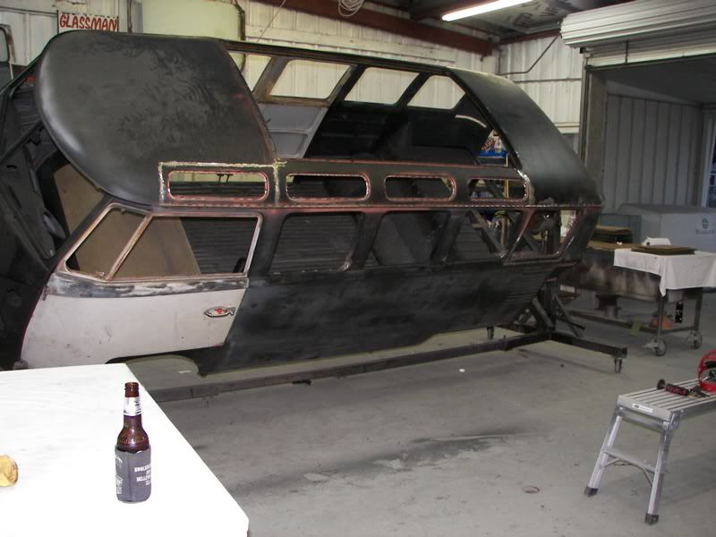

Lets catch up a bit, Home brewed belly pans are in........
Ger$on$ floors are in.............
and started the roof swap.............

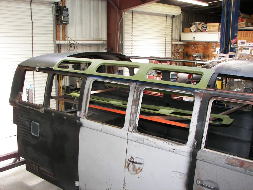

It's coming along....
That's about where it stands now, Roof is going on at this point.

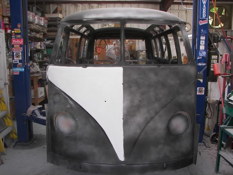

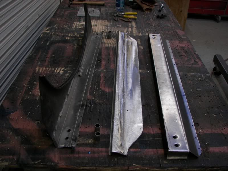

Time for an update...........
Fitting the funk..........
I've changed everything else so why not these too ?...............
This was a big job..........
Crusty cargo doors...........
Assless................
Taking shape now...........

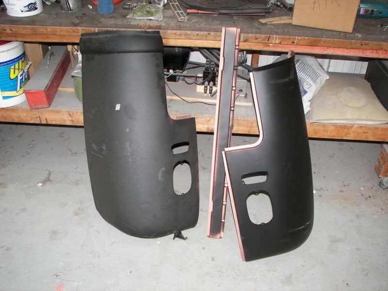

Made some apron parts........

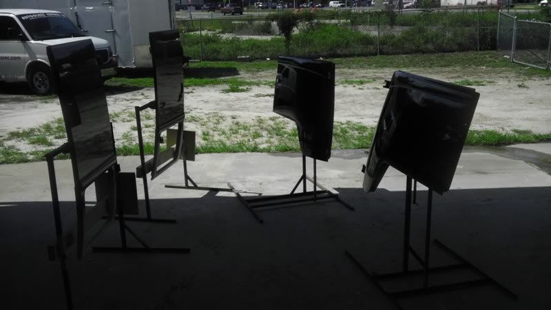

Had all the doors dipped at http://www.autorestorationdepot.com/contact.html

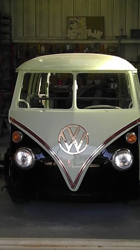

Lookin' better................
Got some insides done too..............
Nose is ready too..........
For more go to http://skidmarksgarage.com/ and click on the Microbus tab.
Thanks for watching and stay tuned.......................

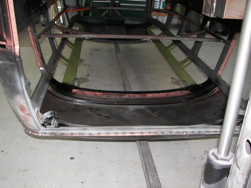

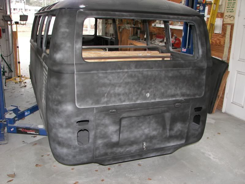

« Reply #18 on: June 02, 2010, 04:16:17 PM »

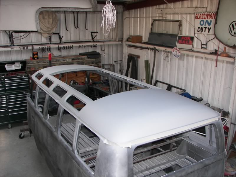

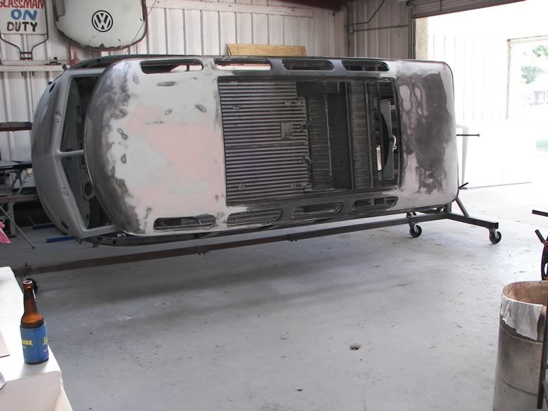

Thanks guys, thought I'd update a bit here, got the interior str8nd out and primed............
Then got the mud work done on the outside of the roof...........
And primed.............
This is my work area...........

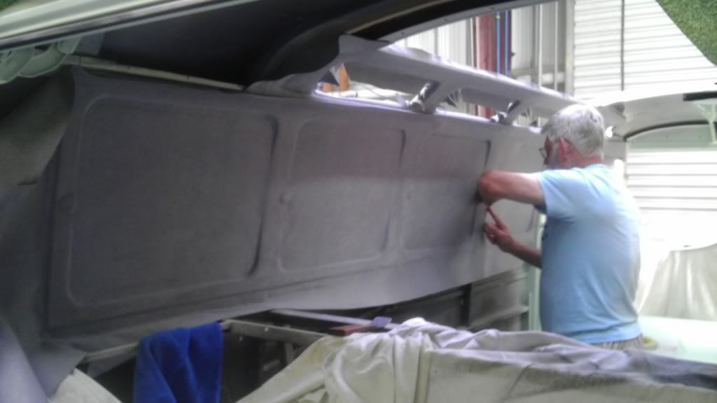

« Reply #19 on: June 23, 2010, 04:55:32 PM »
Got some more done..............
« Reply #20 on: June 23, 2010, 09:04:42 PM »
Whats that wood thing? A big ass straight sander?
 Didnt even notice before that the doglegs are molded to the body now.
What did you spray it with, some super high build primer? Shit almost looks like texture paint.
 Amazing work.  thumbs up thumbs up
skidmark
Posts: 27
« Reply #21 on: June 24, 2010, 08:40:55 AM »

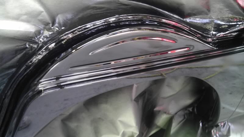

Thanks man, Yeah, that's a 5 1/2 foot sanding block I made, the seam between the Qtr. panel and dog leg got covered up but I'll dig it back up proper wink
The polyester primer is an Evercoat product called Slick-Sand, VERY high build indeed, sort of a spray on filler it's catalyzed with MEK. I use it on everything.

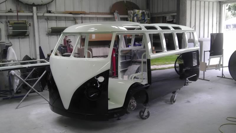

So, I'm getting closer.............
« Reply #25 on: April 25, 2011, 07:47:56 PM »
Great work!  Looks awesome!   thumbs up

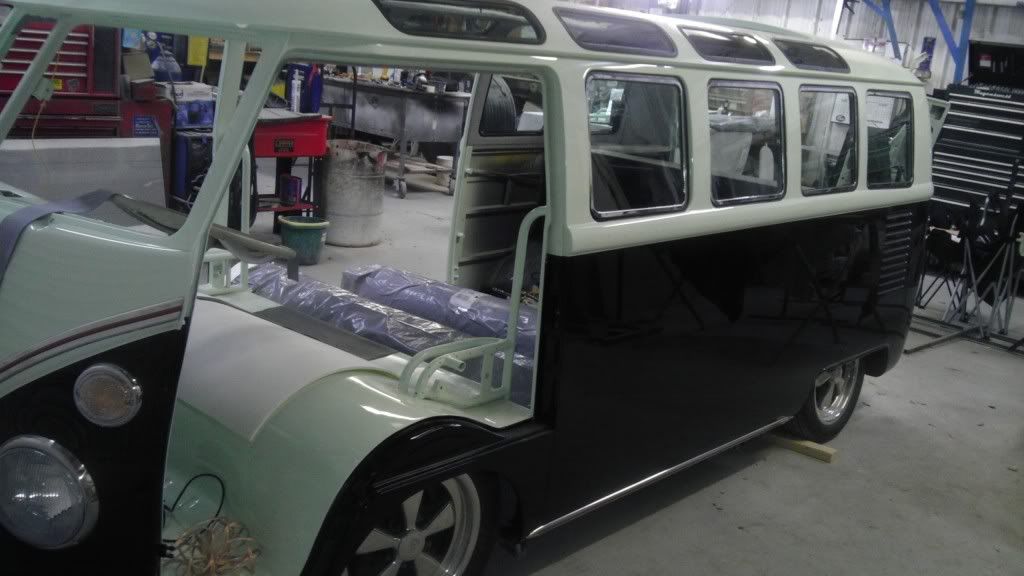

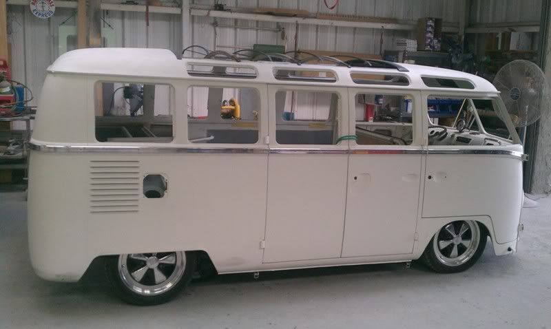

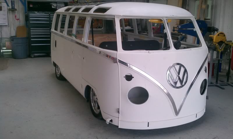

« Reply #28 on: November 19, 2011, 05:30:37 AM »
Nedd to bring you guys up to date, enjoy..........................
For a MUCH more in depth look at the build check out my bus build link below........

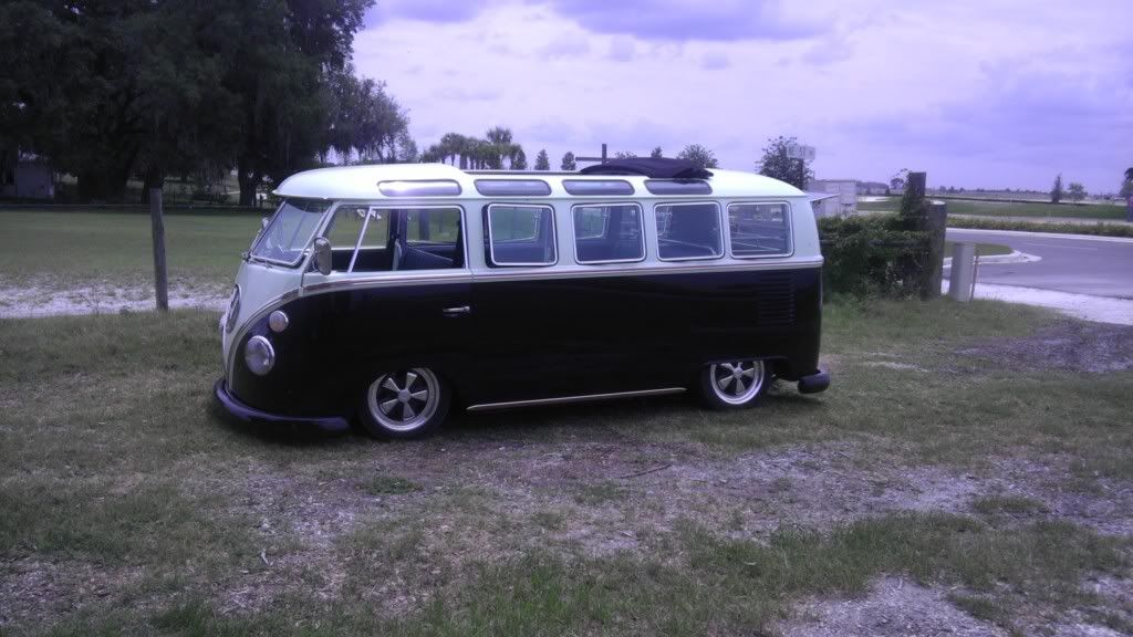

« Reply #33 on: July 10, 2012, 07:59:18 AM »
Been driving the bus and even brought it out to Ca. for the Classic events.....................
First show out at Atlanta Motorspeedway got to drive the track and picked up a couple awards too........

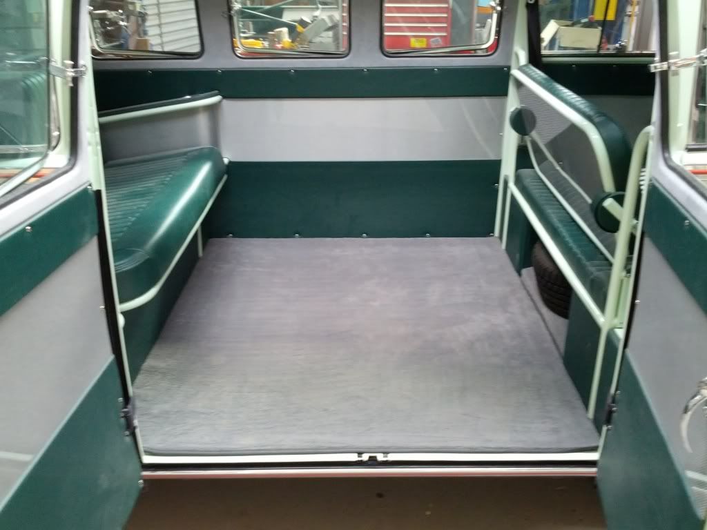

I just sold my auto glass business of 17 years so the green glass was a no brainer for me, Any GOOD auto glass shop can do this for you very easily and don't let them charge you more for green cause it costs the same or VERY little more  wink
Laminated windshields and the rest all tempered.
