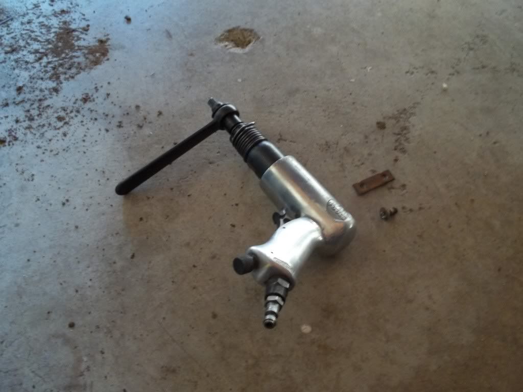

ok so the cargo doors are not playn' nice.. went to do the weld on the bolt trick today while one of the local kids was at the shop he said he can bring a screw knocker over tomorrow after work, i have been wanting to try one so i stopd' at that point and will give this thing a chance! i will let you know how it goes thumbs up

this tool is amazing... it takes door screwa rite out like it was nothing... "Screw Knocker"

If your talking about that phillip's socket I'd have to agree they work great. I have one too.
« Reply #69 on: September 23, 2011, 04:30:17 PM »
Let me just guess how this works.
 I assume you put the socket screw driver on the air chisel (thing) and turn the wrench looking thing as it impacts.
 Yeah?
« Reply #70 on: September 23, 2011, 06:27:42 PM »
thats just rite cage... and even after spray.. soak .. traditional hand held knocker... they wudnt budge,,,     the thingy just took them out almost instantly... truely blew my mind.. its like magic!   shocked hahaha
