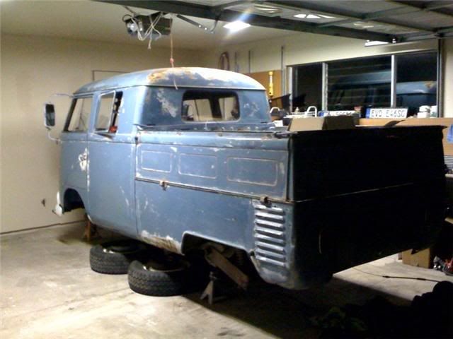

Spent some time today removing the tranny. It was my first time, and I have to say, it wasnt as bad as I thought it would be. The part that took the longest was realizing I was missing a tool, and having to go and buy the tool in the middle of the whole thing. Here's how it sits right now.
Also, maybe someone could give me some info/advice. I have everything cleared out of the way up front for the beam to come out except the shift rod. When I was taking the bolt out, it snapped from being old and rusted, so I drilled it out, but the shift rod will not come apart. Any ideas on how to separate it? I think it's just old and rusted so it wont separate easy. Thanks.
« Reply #4 on: January 31, 2010, 02:55:10 am »
Heat that bitch up until it is RED HOT then give it a little twist.
It will come.......trust me.
Worst case scenario, I have new couplers / tapered bolts.
Cut yours off and replace with a new one.

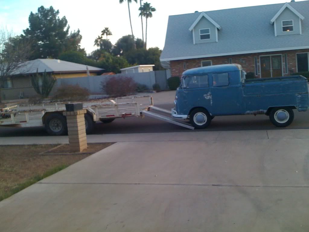

Finally got some time with the bus! Was able to get everything together and get it off the jack stands. Still no engine in it, but now it can come home into my garage and I'll have time to mess with it more often. I am really happy with the way it turned out. The front end is sick, and I can now see the roof of my cab  icon_biggrin The rear is gonna need some adjusting but it will sit level when it's all done. Here's a few phone pics of it in my buddy's garage.
« Reply #15 on: March 12, 2010, 12:48:21 am »
Glad you got it sorted.
It looks much better with he ne, lower stance.
I take it you found the shifter bushings, etc. OK?
