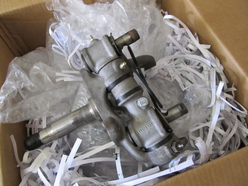

« Reply #134 on: March 17, 2011, 12:01:12 AM »
thanx matt.. they look great! icon_biggrin
Experience is kicking in again, so I'll say it now before you get too far along. Those spindles are early. Early BIG snout brakes probably aren't going to fit inside your wheels without some machining to the drum, wheel, or both. Better off going with late brakes. If you're beam is set up with early arms, go with "63 only" spindles.
http://lowbus.com/BB/index.php?topic=801.0

« Reply #137 on: March 17, 2011, 02:43:11 PM »
wouldnt be the first time i had to grind both down.. lol I even did it to a brand new set of radrs once.. haha im just getho like that

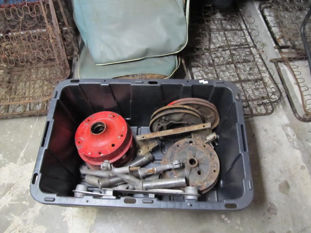

« Reply #138 on: March 17, 2011, 02:50:30 PM »
[/quote]
The spindles and arms are off the same beam... its all at powder coat now... dunno
« Reply #139 on: March 17, 2011, 02:56:22 PM »
here is a shot of my drums...
« Reply #140 on: March 17, 2011, 03:00:54 PM »
the bummer was even after all that grinding.. i had to run small spacers... kinda of a pian.. i had forgot all about it it was so long ago.. lol
« Reply #141 on: March 17, 2011, 03:30:50 PM »
Ive never done it but I guess you can get late spindles and arms and just cut the sleeves off the arms and they will slip right into a late beam.
