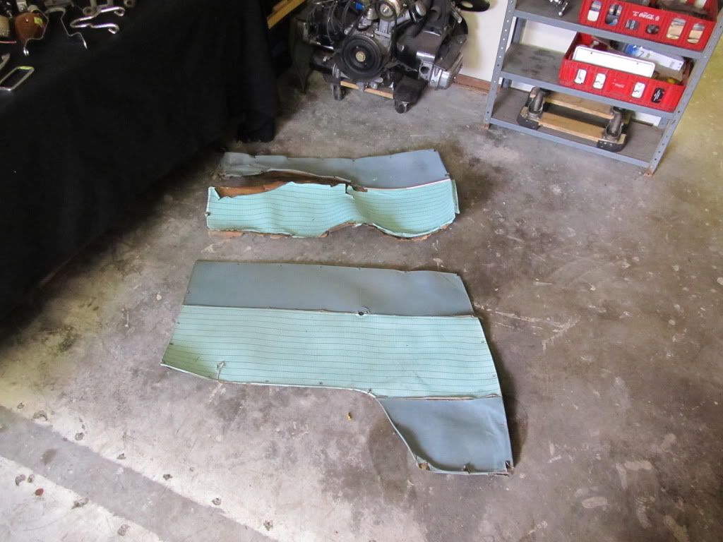

« Reply #90 on: March 04, 2011, 07:33:30 PM »
thanx guys for all the support and feedback/// i love it...
you can see how bad the panel was we took off... the new one is on now and looks like it was always there..
